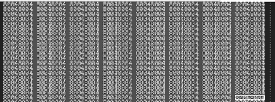

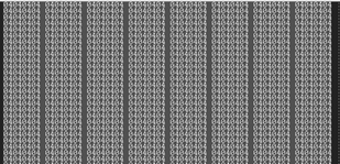

When I observe the data, The frames are not proper and UV component is missing.
The one in left is how the actual data looks and the one in right is how we receive in RT1170.
Actual data of a Black frameActual data of a Black frame     Data received in RT1170Data received in RT1170

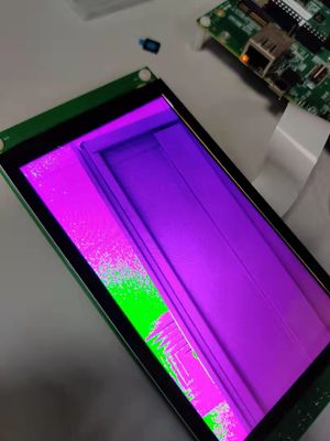

After changing the DEMO_CAMERA_BUFFER_BPP and dataBus as you mentioned, then try a lot of combinations of cameraConfig.pixelFormat and psBufferConfig.pixelFormat, I haven't gotten an ideal output (as the below figure shows).
I guess it is related to the PXP_SetCsc1Mode() function, however, it needs to spend much time to figure out the appropriate parameters.
So I'd like to suggest you refer workspace\evkmimxrt1170_csi_mipi_rgb_cm7, you can configure the CSI to receive the RGB565 format data, then transmit to the LCD directly without the PXP processing.
Maybe you can give it a try.

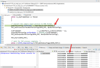

Thanks for the effort. I'm stuck at the same situation. The PXP is not the problem here, if you can check the data(easier with memory monitor in IDE) before giving it to the PXP we can see that the UV component is missing. My assumption is we are setting the CSI receiver in 16 bit and MIPI-CSI2 is giving out data in 24 bit. My end application should send YUV422 over UVC so the RGB suggestion won't work out for me.
You can add the following line of code in static status_t OV5640_SetPixelFormat(camera_device_handle_t *handle, video_pixel_format_t pixelFormat) in fsl_ov5640.c to generate a static black frame and compare the data after our new setting and the default.
OV5640_CHECK_RET(OV5640_WriteReg(handle, 0x503D, 0x83));

Firstly, when observing the data whose start address is the cameraReceivedFrameAddr, I get a similar format as you show before, the two-pixel is identical to each other in the word unit.
Next, we haven't encountered a similar issue before.

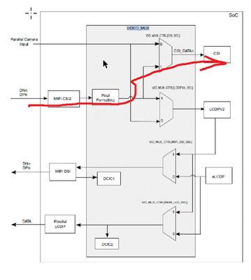

VIDEO_MUX only can output 24bit format (as the below figure shows).
In another word, your purpose is impossible to make it.
