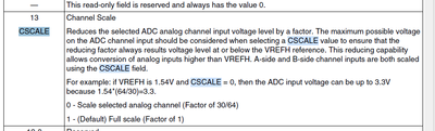

We are using MIMXRT1172AVM8A processor in our board. We want to use ADC feature of the processor. The VREFH pin is connected to 1.8V.
In our device our ADC input signal is 0 to 3.3V range. Can we give this pin directly to the processor ADC channel pin.
If yes, than what modification we need to do in the processor configuration registers for detecting this
0 to 3.3V range at the ADC channel input pin. Please suggest.

Also we would like your opinion if we are receiving the input signal is 0 to3.3V range on the ADC pin then should we connect the vref to 1.54V to sample the complete signal?
The suggestion is 1.54v is not necessary. 1.54v is a example.
We can use 1.8v, then we can get 1.8*(64/30) = 3.84v.  It can cover 0-3.3v.

We configured the CSALE bit to '0' for the particular ADC channel pin and applied varoius signal levels 0V, 1.2V, 1.8V, 2V, 2.5V, and 3.3V.
For levels between 0V to 2.0V, we could read the ADC values as 0 to 3111 (12-bit ADC) but,
For all the voltage levels above 2V upto 3.3V we observed that the ADC is reading 4095 for all the levels 2.1V, 2.5V, 3V, 3.3V.

Firstly, double check if he CMDLx[CSCAL] register is set to “0” rightly in IDE and this CMDLx is right associate ADC channel corretly.
Secondly, please make sure your supply signal ground connect to the board ground.
Thirdly, you can set CMDL[CSCAL] to “1”,and then check that give 0V, 1.2V, 1.8V,the ADC values is right or not.

As you said we checked by setting CMDL[CSCAL] to “1” we are getting correct values as mentioned in the table.
But we want to measure ADC voltage from 0 to 3.3. Hence after setting CMDL[CSCAL] to "0" the input range is extended till 0 to 2V only i.e.
Input    |   ADC value
0V        |         0
2V        |    4095
Is this right in case of Vref = 1.8? or should we set the Vref = 1.54?

Leon_Li1
Hi vihang_vinayak,
It is right when Vref = 1.8.
 When set CMDL[CSCAL] to "0", the ADC result should be
SignalADC value(12 bits)
0v0
1.2v1280
1.8v1920
2v2133
Please double check ADC value of 1.2v and 1.8V. Make sure the CMDL[CSCAL] to "0" rightly and work.

We tested with the code you shared and we were able to read  2133 at 2V, and 1280  at 1.2V and can go up till 3.3V.
Can you please share in detail what changes you made in the code to get the above values. This will help us to correct our approach for other ADC pins configuration
Thank you for your valuable support and help.
Vihang
3,928 Views
Leon_Li1
Due to use SDK version: 2.12.0, I only changed "triggerPrioirtyPolicy" to "triggerPriorityPolicy" in line 140 of peripherals.c. Please make sure your SDK version No..
