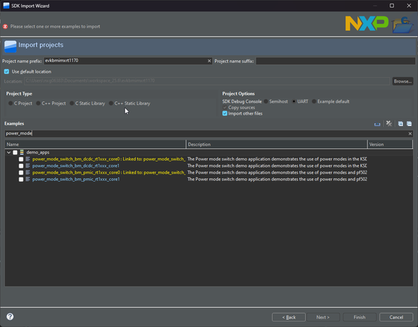

Low power management on the RT1170 is a bit more complex. It is possible to wake up the device through the RTC, which is controlled by the SNVS module.
For more detailed information about low power modes, you can refer to this app note that explains these modes in depth, along with all the considerations required to enter low power states.
Additionally, the SDK (version 25.09) provides examples demonstrating the use of power modes, depending on the power source you are currently using, as shown in the following image:
I highly recommend reviewing the README file included with these examples to understand how they work.
