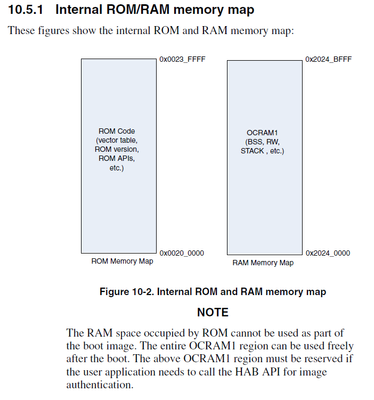

Yes, this is expected behavior.  Some portion of OCRAM1 is used during startup so it also needs to be considered on the offset.

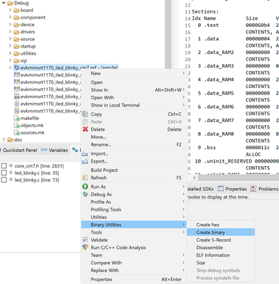

muhammadumairkh
Hello @Omar_Anguiano . Thanks for the response.
I generated by bin file by right clicking the axf > Binary Utilities > Create binary as below:
And yes, both the axf and bin belong to the same project.
-Umair

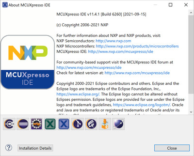

Omar_Anguiano
Thank you for the information.
Could you please attach a screenshot of the values written in the following path of MCUXpresso:
Windows->Preferences->Utilities.
Additionally, which IDE version are you using?
Omar
8,246件の閲覧回数
muhammadumairkh
Hi @Omar_Anguiano . Thanks for the response.
Below are the screenshots for both:
and

I have another observation and a question. You suggested in your earlier comment to set the OCRAM_BASE to BASE + 0x3000 but I see that it does not boot until the offset is greater than or equal to 0x10000 (0x2025000). I tried below values but none worked:
  1. BASE + 0x3000 = 0x20243000
  2. BASE + 0x4000 = 0x20244000
  3. BASE + 0x4000 = 0x20244000
  4. BASE + 0x5000 = 0x20245000
  5. BASE + 0x6000 = 0x20246000
  6. BASE + 0x7000 = 0x20247000
  7. BASE + 0x8000 = 0x20248000
  8. BASE + 0x9000 = 0x20249000
However, below combinations work:
  1. BASE + 0x10000 = 0x20250000
  2. BASE + 0x11000 = 0x20251000
  3. BASE + 0x12000 = 0x20252000
My question is that is it the expected behaviour?
Thanks.

Omar_Anguiano
Omar
7,934件の閲覧回数
muhammadumairkh
Thanks @Omar_Anguiano . So it looks like we need to add a 0x3000 offset after the reserved RAM space. From the figure you attached, the correct address comes out to be 0x2024BFFFF + 0x3000 = 0x2024FFFF which is what I observed.
Anyway, thanks for the continued support. This answers my question.

The steps are the same as using an internal RAM
1. Select Project > Properties - C/C++ Build > Settings > Tool Settings > MCULinker > Managed Linker Script and check Link application to RAM.
2. In Project > Properties > C/C++ Build > MCU settings, delete Flash, and modify SRAM_OCRAM to start at (BASE + 0x3000) with size (SIZE - 0x3000).
3. Move SRAM_OCRAM to the first position to make it default.
4. Build the image.
Then you can use MCUBootUtility to load that image.
Omar
