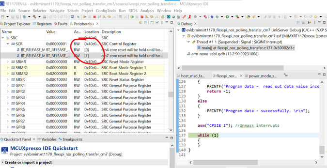

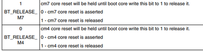

When the BT_RELEASE_M4 bit is set, from the information which given in the RM, it means that M4 core reset is released. What should I understand from "reset is released" and "reset is asserted" sentences. I thought when the reset is released, core is running. When reset is asserted, CPU is in in reset state. Do I miss understand the RM or how can I make the link between CPU run mode and BT_RELEASE_M4 bit in SRC?
When I run the M7 example codes, SRC register has value 0x01. It indicates that M7 core reset is asserted and M4 core reset is released.
You said "the RT1170 boots up from M7 by default and M4 keeps in reset state until M7 kicks it off" before, can you give me an reference from RM about that information. I could not find that in the RM.

Just to clarify that src=0x01 means M7 is released but M4 is held in reset.

Yes, your understanding about the reset assert/release is correct. and you may easily have the similar conclusion with the following contents from the RM:

If my understanding is correct, then why I am getting the 0x01 value from SCR register while my application only contains M7 core?

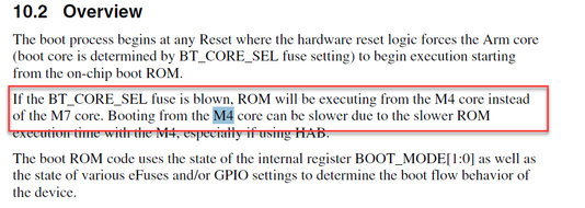

The information you gave from RM is about the BOOT Rom code, it does not describe the application. When rom done its job, the code will jump to main. After that time, what will be cores power modes? Also this section describe which core will be execute rom code, it does not clarify the other core mode when one of the cores run rom code.

Did you run any SDK demo for M7 or some custom project? When M4 is out of POR but hold in reset state, it is in RUN mode but not running.

omerfaruky
Hi @Kan_Li ,
Yes I run SDK demos for M7 core. and I checked SCR register value. It was 0x01. "it is in RUN mode but not running" -> how can I get this info while my M7 core is executing my application code?
