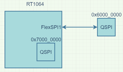

Hi team,
We are having iMXRT1064 with 16MB External SPI Flash and also having 4MB Internal Flash.
As of now we are running Secondary bootloader and Application in Internal Flash. But now we want to run bootloader from Internal flash and  Application from External Flash.
So now we want to how to implement XIP on our bootloader to execute the Application from External flash.
Or any other approaches are available for this?

jeremyzhou
1) Or any other approaches are available for this?
-- In my opinion, this scheme is feasible, firstly, you should generate an image file that links to the external QSPI, next, load the image file to the external QSPI, and it should initialize the external QSPI prior to the jump operation.
BTW, you can refer to the evkmimxrt1064_flexspi_nor_polling_transfer
to learn how to initialize the external QSPI.

Hi Jeremyzhou,
We have loaded the application in external flash at memory 0x60xxxxxx. In bootloader we have done the same init sequence as "evkmimxrt1064_flexspi_nor_polling_transfer" in the program mentioned. then we point our application entry and vector table to external flash in the bootloader. But its not jumping to the external flash and not execute in place.
We know that we can read the external flash application  to RAM from bootloader and then we run our application. But we don't want this approach.
if i can include xip header (FCB) in external flash application image. then what changes we have to do in bootloader to execute the application from external flash.
We are thinking we need some logic has to develop in bootloader to have XIP in external flash.

jeremyzhou
Thanks for your reply.
I make it now, and I'd like to share the below experience.
1) The bootloader that resides in internal QSPI should initialize the external QSPI prior to jumping to.
2) The application should be programmed to correct the area in the external QSPI.
3) In the application, it should avoid initializing the FlexSPI1 that connects the external QSPI.
TIC
