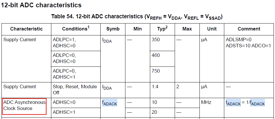

I have a question pertaining to the asynchronous clock source in the ADC peripheral of the iMXRT1064 (ADCx_CFG.ADICLK = 11b). The reference manual states that the asynchronous clock is “generated from a clock source within the ADC module”, but what exactly is the value of fADCK if I choose this clock source? I’d like to know what value it is for purposes of calculating the conversion time.

Hi John Pulera
for the opportunity to serve you.
Please check the Fig 1.

Hi Jeremy,
Thanks for your prompt reply. So, just to confirm my understanding, fADACK is either 10MHz or 20MHz based on ADHSC setting, regardless of the IPG Clock frequency and divider settings. Is this correct?

Hi John Pulera
Thanks for your reply.
Yes, you're right.
