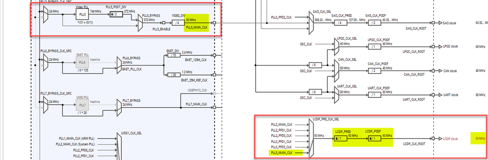

victorjimenez
Hello Krzysiek,
Thanks for sharing more information! I completely skipped the modifications made inside the function BOARD_InitLcdifPixelClock. I made some tests on my side and I was able to reproduce the behavior you mentioned. However, the behavior showed is perfectly normal, let me explain why.
The function BOARD_InitLcdifPixelClock, as you stated, it overwrites the clock configuration. However, it changes more things, not just the dividers. With the following lines of code, you are initializing the VideoPLL/PLL5 at a frequency of 93MHz.
     * Initialize the Video PLL.
     * Video PLL output clock is OSC24M * (loopDivider + (denominator / numerator)) / postDivider = 93MHz.
    clock_video_pll_config_t config = {
        .loopDivider = 31,
        .postDivider = 8,
        .numerator   = 0,
        .denominator = 0,
    CLOCK_InitVideoPll(&config);
Now, with the following lines, you are overwriting the clock configurations.
     * 000 derive clock from PLL2
     * 001 derive clock from PLL3 PFD3
     * 010 derive clock from PLL5
     * 011 derive clock from PLL2 PFD0
     * 100 derive clock from PLL2 PFD1
     * 101 derive clock from PLL3 PFD1
    CLOCK_SetMux(kCLOCK_LcdifPreMux, 2);
    CLOCK_SetDiv(kCLOCK_LcdifPreDiv, 4);
    CLOCK_SetDiv(kCLOCK_LcdifDiv, 1);‍‍‍‍‍‍‍‍‍‍‍‍‍
With the first line, you are selecting the source clock for the Lcdif, in this case, it will be the PLL5, which you configure before to run at 93MHz. If you change the PreDiv to one, the LCDIF clock is going to be 93MHz, this is out of spec since the maximum allowed frequency is 75MHz.
I made some changes on the clock configurations on MCUXpresso Config Tools, to show what is the final configuration that you have when you exit the function BOARD_InitLcdifPixelClock and you set the PreDiv to one. I think this helps to clarify what I mentioned before. To be inside the spec, the value of PreDiv must be at least 2.
Victor

krzysiekch
Hi Victor!
I am not 100% sure but i don't think you are right. Changing the divider value to one in the line:
  CLOCK_SetDiv(kCLOCK_LcdifPreDiv, 1);
Sets the division factor to 2. The configuration you described (LCDIF clock set to 93 MHz) requires changing the mentioned values to 0. I checked that using the configuration tool. Setting both values to 1:
divides the clock by 4, so the output value should be 93MHz/4 = 23,25MHz.
Also looking at the original comment: the clock source is 93MHz (Video PLL) and it is divided by 10 to obtain the value of 9.3Mhz. It is done by setting those two division values to 4 and 1. The total division factor is then (4+1)(1+1) = 10.
Krzysiek
2,590 Views
victorjimenez
Hi Krzysiek!
You are right! Sorry for the misunderstood. I'm currently checking what might be causing this behavior with the applications team. I will give you an update as soon as possible.
Victor

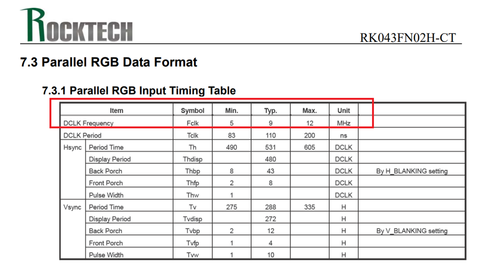

victorjimenez
Hi Krzysiek!
In the datasheet of the LCD (link), table 7.3.1 indicates the maximum of DCLK frequency is 12MHz and the typical is 9MHz, this is why the example is configured with 9.3MHz. If you exceed the maximum allowed frequency we cannot assure the correct functionality of the LCD.
https___community.nxp.com_servlet_JiveServlet_showImage_2-1173345-271360_pastedImage_1.png
Victor
2,590 Views

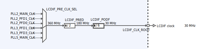

krzysiekch
Hi Victor.
I suspected that this may be the case and it looks that it is not related to my problem. However in the meanwhile I found potential solution for my problem too. I changed the source clock for the LCD interface to PLL3_PFD1 and set the dividers to 2 and 6.
This configuration generates 30MHz pixel clock that corresponds to my display requirements. The interesting thing is that other divider configurations I checked do not work and cause the same problems. Unfortunately I don't understand why this configuration works. Maybe the core clock (600MHz) needs to be the multiple of the pixel clock? I will try to do some more research regarding this issue. I will be grateful for any suggestions.
Krzysiek
