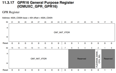

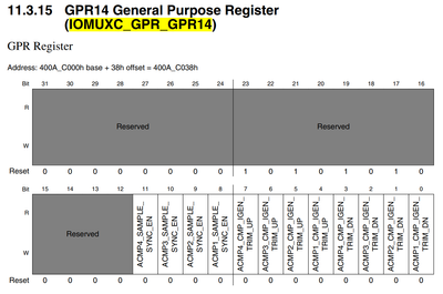

I follow the AN12077 to demonstrate the FlexRAM configuration, but I can't find INT_xTCM_EN/CM7_CFGxTCMSZ fields in IOMUXC_GPR_GPR16/IOMUXC_GPR_GPR14 as section 2.1.2. shows.
Is there anything wrong?

These fields appear as reserved because it was determined that the user should not modify them.
For testing FlexRAM reallocation I suggest you follow these steps: Reallocating the FlexRAM - NXP Community
