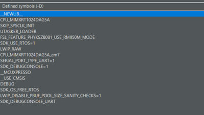

Here is the defines I pass in (as previously stated, have also tried with DEBUG_CONSOLE_TRANSFER_NON_BLOCKING)

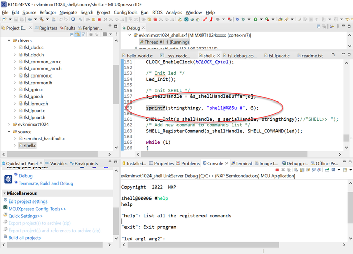

Kan_Li
Hi @GUnderdown ,
I have tried with the similar code on my board, but it works well.
I tested it based on the Shell demo with RT1024EVK, and debug console on semihost. Have you tried  with the same ?
Kan
