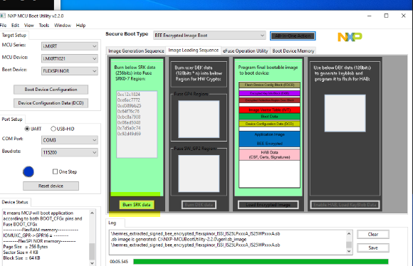

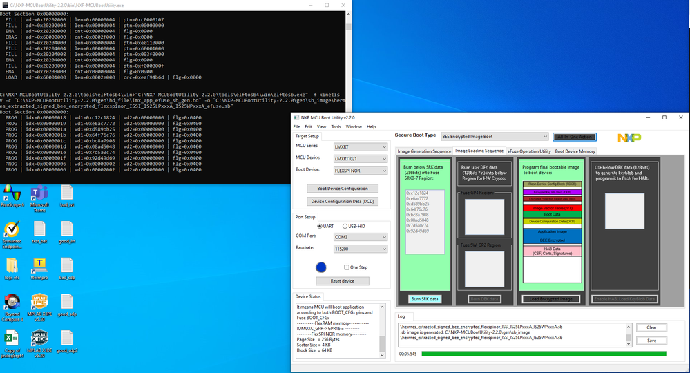

I am using the iMXRT1021 with flexqspiNOR flash. We want to encrypt the .sb image and the use on-the-fly BEE decryption. I am using the elftosb.exe, sdphost and blhost to produce and flash the .sb image.
This all works for normal (unsigned) image, but I cannot get the past the first stage of encryption.
I have downloaded, "Code-signing-tools", "openssl", "ubuntu shell for win10". I can create all the SRKs and certificates.
elftosb\elftosb.exe -f imx -V -c bd_file\imx-flexspinor-normal-signed.bd -o elftosb\img\ivt_output_xip.bin elftosb\img\hermes.s19
results in a ivt_output_xip.bin with 0kB.
Second stage..
elftosb\elftosb.exe -f kinetis -V -c bd_file\program_flexspinor_image_qspinor_encrypt.bd -o elftosb\img\encrypt_hermes_image.sb elftosb\img\ivt_output_xip_nopadding.bin
results in...
failed to open source file: elftosb\img\ivt_output_xip_nopadding.bin (ignoring for now)
error: line 55: error opening source 'myBinFile'
And no .sb image is produced.
Please advise how I can generate an encrypted .sb file, download and execute with BEE.

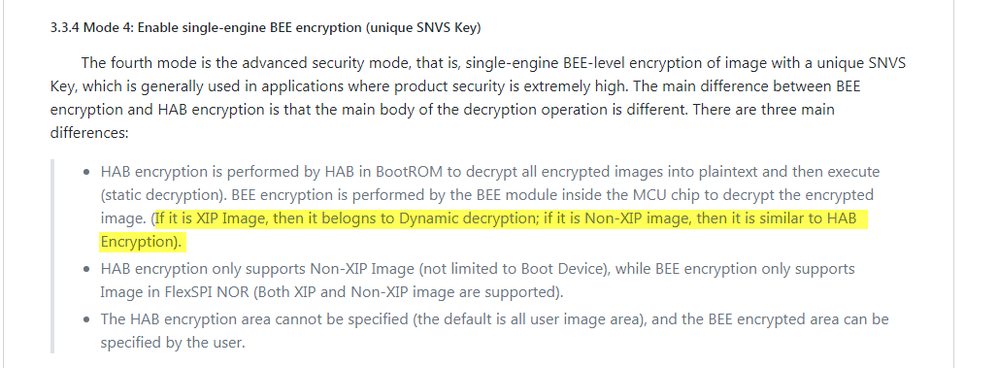

kerryzhou
I'm trying to understand what issues could be causing my startup problem.
One possibility is ramfuncs?
I have a number of functions that are designated ramfunc. On startup they are copied from flash to ITCM and then executed from that location.
What I would like to know is;
Is the ramfunc flash resident code de-crypted on-the-fly when it is copied to RAM and then executed as unecrypted code?
Or are the functions copied encrypted into RAM and then de-crypted by BEE on execution from RAM?
I thought the BEE was coupled to the flexspi bus (external flash) but I'm not sure about ITCM?
Please enquire.

kerryzhou
Hi Tony Thurgood,
   Thanks a lot for your effort and test result.
   So, now, your issue is the BEE encrypt boot problem with your own board?
   1, Please share your own board app source .srec code, and the corresponding BEE secured code which is read out from the MCUBootutility tool, BEE code is c14_enc_image.docx right? I still need your source .srec code.
   2. What's the situation of your encrypted_xip pin on your own board? GPIO_EMC_18(BT_CFG[0]).
     If you already fan out this pin, I highly suggest you use the external GPIO boot at first, which I have told you in the previous reply, I just want to do it very carefully, step by step, fuse modification(bt_fuse_sel and encrypted_xip) should be put in the last stage after we make sure the BEE encrypt boot works with your own board.
   3. What's the boot mode you are using after you burn the bt_fuse_sel and encrypted_xip? You need to set boot mode=00.
   4. Please enter serial download mode, connect your own board, and readout the fuse map, and send me your newest fuse map which already include the modification for bt_fuse_sel and encrypted_xip.
   5. About your request for image_enc2 source code, I will help you to check with the author in the next week, now is the weekend time. In the future, if you use RT1010 OTFAD, I also would like to help you, you can create the new case or new post and let me know at that time, if you really need my help.
Anyway, let's do it together, try to make your own board BEE boot works at first.
   6.  About your question: Is the ramfunc flash resident code de-crypted on-the-fly when it is copied to RAM and then executed as unecrypted code?
Answer:  If it is the RAM code(non-XIP), in fact, jay already mention it in the tool readme:
It is simliar to HAB, it will decrypted it and copy to RAM, then run from RAM.

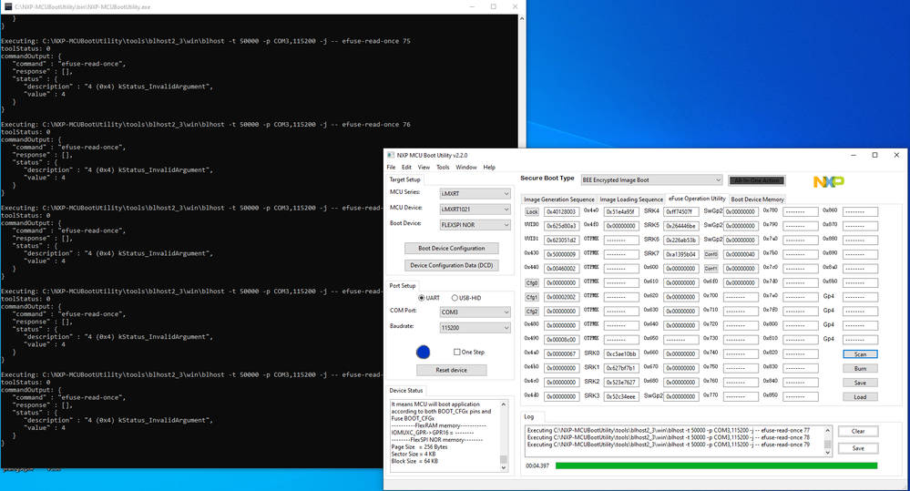

1.   When you try the  image.bin in DEV download mode, don't burn any fuse, whether it boots OK or not?
2.  Your BT_CFG[0] is totally didn't fan out? Or just connect to other modules?
     If you already fan out, I highly suggest you try to use the external EncryptedXIP pin at first, after the boot really works, then we can burn the EncryptedXIP fuse again.
3. After the chip is secured, you really can't use the JTAG to debug it directly. So, normally, we do the secure function in the product last phase.

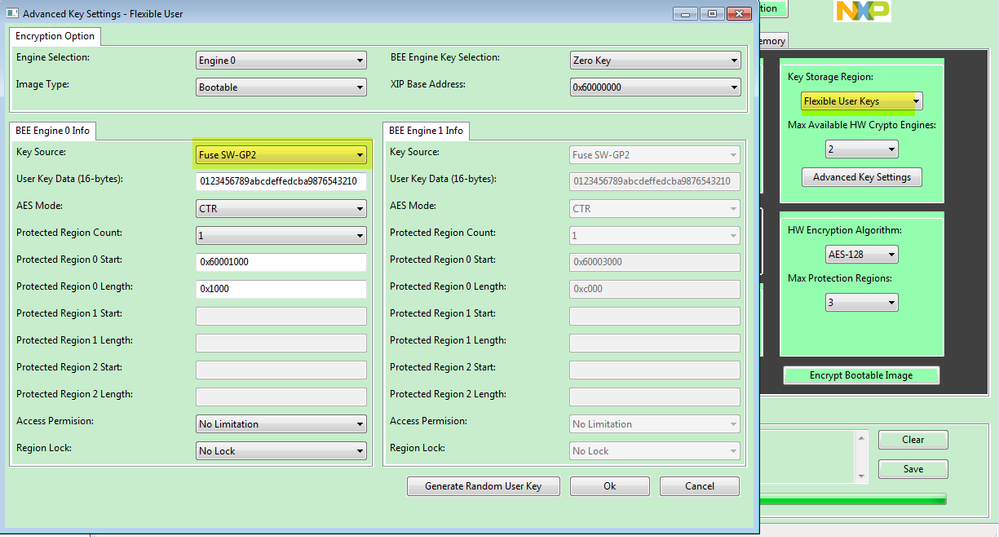

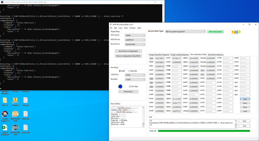

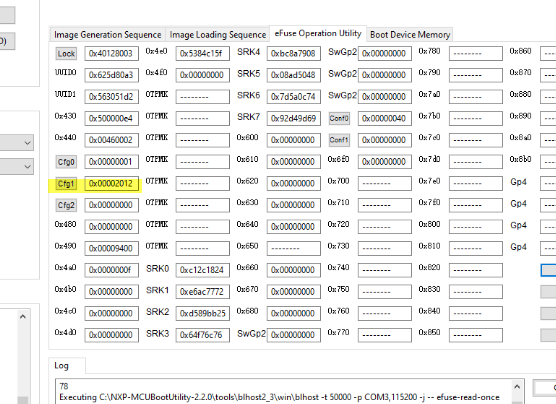

4. The user key should also works, anyway, I think you can follow my OTPMK key at first, after it works, then we can go to the user key together.
   But the very important result from your side, you said you are using the user key, your fuse map result doesn't like what you have said.
0X460 is 0x00002012, what does it mean?
It means you are still choosing the OTPMK not the SWGP2.
Are you use you have chosen the user key?
BTW, if you choose the key, you need to share your configuration picture.
Anyway, your BEE_KEY0_SEL is 10 now, not 11.
Kerry

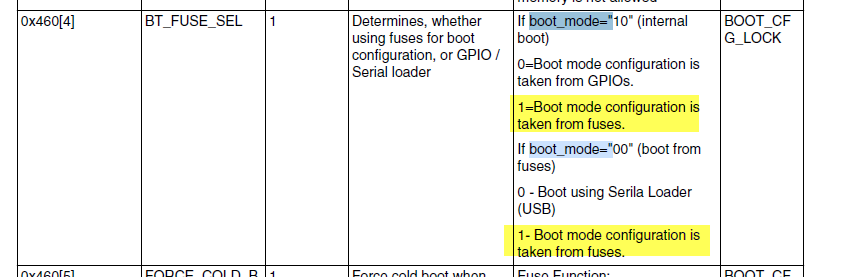

t_thurgood

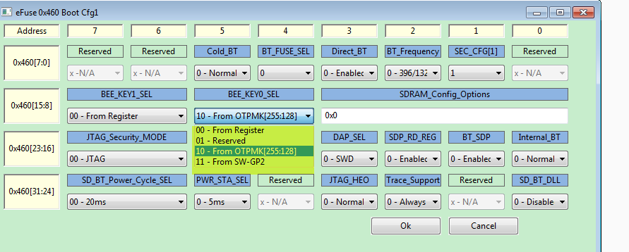

I didn't "choose" the BEE_KEY0_SEL, that was done by the "All in one action" (probably taken from the Advanced Key Setting).
0X460 is 0x00002012...
15  14  13  12     11  10  09  08
  0    0    1    0       0    0   0    0          =  10-From OTPMK[255:128]
07  06  05  04     03  02  01  00
  0    0    0    1       0    0   1    0          =  BT_FUSE_SEL  and  SEC_CFG[1]
SEC_CFG[1] closes the HAB, which is forced by the Tool download. This is a subject of contention, discussed previously on this thread.

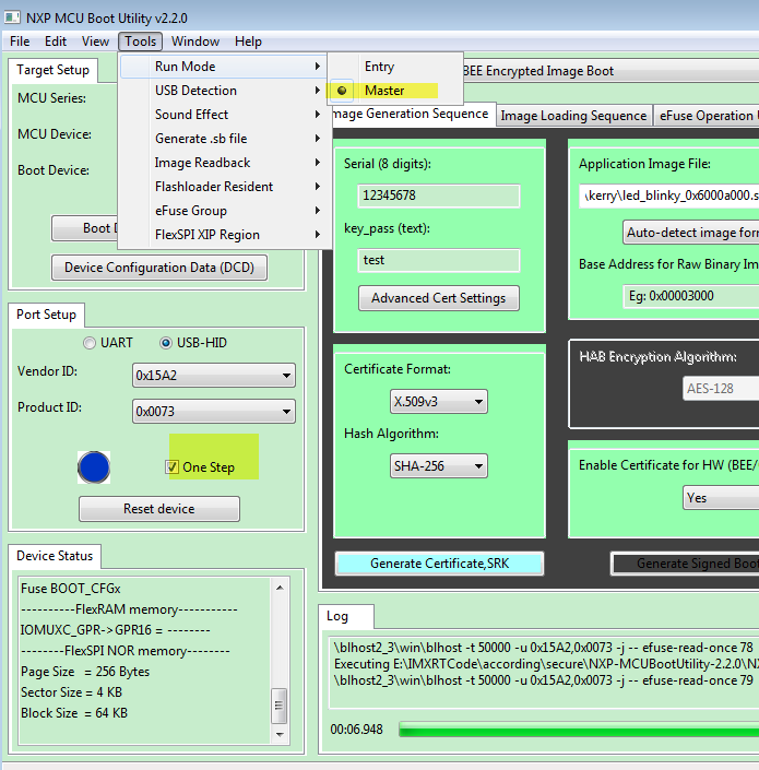

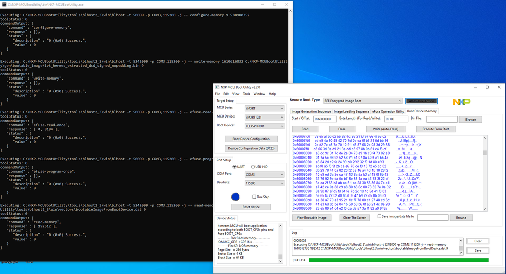

Anyway, I did manage to get an MIMXRT1020 EVK. I got a clean copy of MCU_Boot_Utility and CST, added the image_enc.exe.
Set to Master mode and Generate .sb file = off.
From the ...NXP-MCUBootUtility\apps\NXP_X-IMXRT1020-VAL_Rev.A, I accessed led_blinky_0x6000a000.srec. I setup the tool for Dev Unsigned Image Boot and downloaded the image. Reset to internal mode and the led blinked confirming all working.
I then setup the tool for BEE Encrypted Image Boot, generated the keys and certs. Used All In One and performed the complete download and fuse blow.
Switched to Internal mode and the led blinks ok. I was also able to erase the flash and repeat the image download with "user selected region", all working ok.
So I think having a clean copy and not using .sb has contributed to a good result. I will now try the same with my srec image and target board.

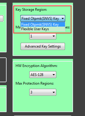

Hi Tony Thurgood
  I am really very happy that you have make it work on the MIMXRT1020-EVK, at least it is the progress.
 Now, you can do the same operation on your own board.
  About the BEE_KEY0_SEL, it is related to your BEE secured key source.
If you choose SNVS, then BEE_KEY0_SEL is 10, but if you choose user key.
then your BEE_KEY0_SEL will be 11, this is what the detail information which I want to tell you in my above reply.
Anyway, if you have any difficulties, please kindly let me know.

t_thurgood
kerryzhou
Ok, I am happy with Fixed OTPMK from the snvs module.

Using my srec image and target board, I setup with the Tool.
I used All-in-one to download an unencrypted image, reset and that ran normally.
I selected BEE encryption and used the settings/certs that I used on the EVK. I used All-in-one to perform the download and fuse blowing. I additionally set bt_fuse_sel and encrypted_xip. then power cycled the boad.
It failed to run.
So I know the unencrypted image works with the tool and target. I know the encrypted demo app runs on the EVK.
For some reason my target + encryption doesn't start.
I have attached logs, pngs and a copy of "View Bootable Image".

Please also choose the master mode and one step, just the same as me:
Kerry
5,038 Views
t_thurgood
Yes, I always have master mode selected. The "one step" only defines how the tool connects to the flashloader via the serial port. Doing that manually makes no difference. Sometimes connecting can be a bit erratic, so that why I used single step.
5,038 Views

3. connected the target board, selected image file, set the Advanced settings, Generated .sb selected.
4. Clicked "All-In-One-Action"
The tool ran for 5 seconds, but then hung up without downloading the image or blowing any fuses.
I have attached logs and images.
5,040 Views
kerryzhou
Hi Tony Thurgood
  Good that you get the files.
  1. Do you tried your board like me with DEV unsigned image boot mode and readout the orignal fuse map at first?
     This is important.
     Please try DEV unsigned image in the new chip at first, and switch to the boot internal mode, make sure your board normal download and boot have no issue.
   2. If the DEV unsigned image boot works, then you can try the BEE mode.
      If you find the fuse map is not burn after you download BEE code, please click the following button in your picture:
Burn SRK data, if your fuse is not burn automatically, just as Jay told you, he leave the fuse burn to the customer instead of the tool download it directly.
In your picture, I find your SRK table already list, you just need to click Burn SRK data.
But you said, the tool even didn't burn the image, I highly suggest you try the DEV mode instead of BEE mode directly, make sure your board configuration is correct, you need to select the correct external QSPI flash.
Any updated information, let me know ASAP.
