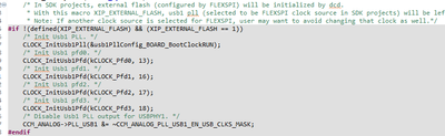

victorjimenez
I made some tests on my end and I didn't face any problems initializing the LPSPI module when I bypassed the PLL. For these tests, as a clock source for the LPSPI module, I selected the PLL2 PFD2. Keep in mind that in the SDK examples even if you modified the PLL3 in the MCUXpresso Config tools this won't have any effect due to the following condition.
