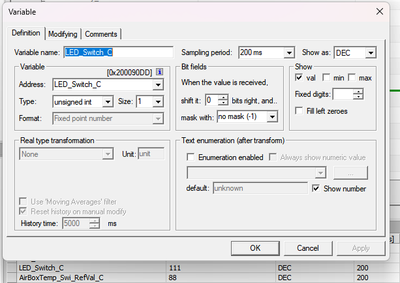

But when reviewing the Ram addresses:
0x200090dc AirBoxTemp_Swi_RefVal_C: 111
0x200090dd LED_Switch_C: 88
