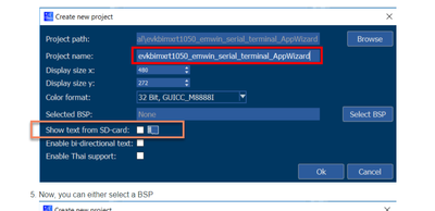

  About the UI resources onto SD card, do you know the detail data in the code? If yes, you totally can write it to the SD card, about the UI, eg,
it has one item to select show text from SD CARD, whether this meet your demand?

Exactly this is the bottleneck point. After selecting this 'Show text from SD' what next steps should be taken. Same question for 'Show image from SD'. After selecting this option would the AppWizard itself place all the marked UI resources to the SD card connected to RT1064 or the developer will have to store them manually. And if manually, then at which location (exact path in case of file system) ?

  Please read the AppWizard related document at first:
https://www.nxp.com/design/software/embedded-software/nxp-emwin-libraries:EMWIN-GRAPHICS-LIBRARY?fps...
UM03003, AN03003
That Segger document has more information about the sd card selection.
