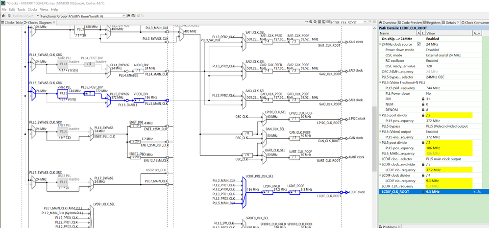

The first calculated 9.2MHz clock frequency is LCD pixel clock frequency.
The eLCDIF clock source from PLL5, which clock source is 24MHz.
It doesn't need to enlarge fixed to 10 times with 93MHz of PLL5 output clock.
I just use MCUXpresso config tool to let PLL5 output clock frequency with 186MHz.
Then it also could get 9.3MHz LCD pixel clock.
Please check below picture for the detailed info:

Wish it helps.

I see. So there are 2 stages of scaling. I missed the CLOCK_x(); statements thinking they only set the mux.
 CLOCK_SetDiv(kCLOCK_LcdifPreDiv, 4);
 CLOCK_SetDiv(kCLOCK_LcdifDiv, 3);
