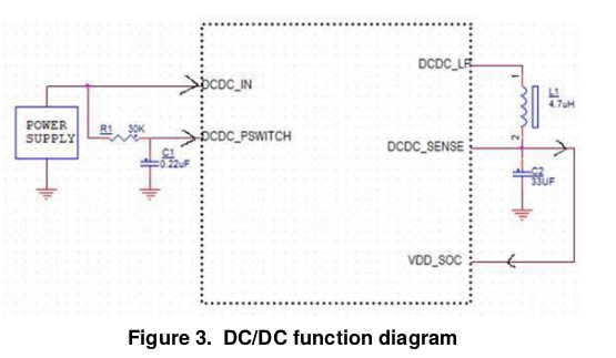

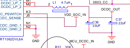

DCDC-LP
Here the Hardware Development Guide says:
The EVK schematics shows:
Is the C37 required ? Also, there is also a lot of decoupling caps on VDD_SOC_IN that would count in the 33uF as the Hardware Development guide says. Should we lower C36 value?
What should we follow on those two cases ? EVK schematics of Hardware Development Guide ?

fangfang
Hardware Development Guide is the reference for the customer. EVK schematics is confirmed by our expert team. You may refer to the Hardware Development Guide and follow the EVK schematics.
