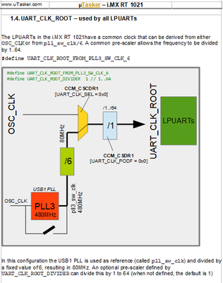

iMX RT1010 has only 2-way UART_CLK_SEL, but ConfigTools/SDK offers a 3-way mux
4,987 Views
benedek_kupper
I wanted to change the UART clock input so the PLL3 could be disabled. So I went ahead and chose PERCLK_CLK_ROOT in the clock tree configurator (MCUXpresso IDE v11.2.1 [Build 4149] [2020-10-07]). It broke all UART connections completely. I had to do a lot of digging to find in the reference manual that this chip has actually a 2-way clock mux (PLL3_SW / 6 or OSC_CLK), there's nothing connected on the 3rd mux input.
This is clearly a bug in the ConfigTools and in the SDK (or in the silicon and in the reference manual), please fix it where appropriate.

The clock tree in the reference manual is wrong since the perclk is an option for the UART in the RT1010, this will be fixed in future releases of the reference manual.
The SDK example doesn't work when you select this as the clock source because there is a clock gate between the clock root and peripheral, if you enable this gate, you will find the UART can work well.  To activate this gate please call the following function in your main before you configure the UART.
CLOCK_EnableClock(kCLOCK_Pit);
Also, there's a problem with the function BOARD_DebugConsoleSrcFreq of the SDK, this function doesn't support the perclk option. This will be fixed in future releases of the SDK as well. In the meanwhile you can change this function manually, it should look like the following:

victorjimenez
The UART in the RT1011 does have three different clock source options, you can see this in the register CCM_CSCDR1 under the UART_CLK_SEL field. There is a problem with Figure 14-3 of the reference manual because in this clock tree we don't mention the per_clk_root, I already reported this to the documentation team so they can fix it in future releases.

mjbcswitzerland
Specialist V
Such an error will not be restricted to the 1011 since the LPUART clock is the same in all i.MX RT 10XX parts.
From the uTasker developer's practical  guide: https://www.utasker.com/docs/iMX/i.MX_RT_1021_uTasker.pdf (1011 guide points to this one for the UART clock since it is globally the same) these are the two possibilities:
The guides are available for a complete list of all clocking possibilities to more easily visualise the capabilities and restrictions.
As noted, there is in fact a third configuration of 4MHz when PLL3 disabled (but bypassed) but it is not a very interesting method.
Maybe the config tool is trying to do this but forgets to bypass the PLL? Or you have manually changed the bypass setting in the process of disabling the PLL?
