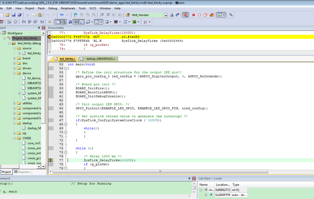

I started to use i.mx rt1020 evk board and I try to create a new project using keil ,but there is always errors.
How can I create a new project on keil ?Is there any document in this topic?
There is an error when I run led_blink example .No Algorithm found for: 00000000H - 00001AB3H.Erase skipped!Error: Flash Download failed  -  "Cortex-M7"

    At first, I think you can run the official SDK code at first, after it works correct, then you can try to great the new MDK project.
    After you download the SDK for I.MX RT1020 from this link:
 Welcome | MCUXpresso SDK Builder
Please open this folder: SDK_2.5.0_EVK-MIMXRT1020\docs
Refer to Getting Started with MCUXpresso SDK for MIMXRT1021.pdf, chapter 4 Run a demo using Keil® MDK/μVision.

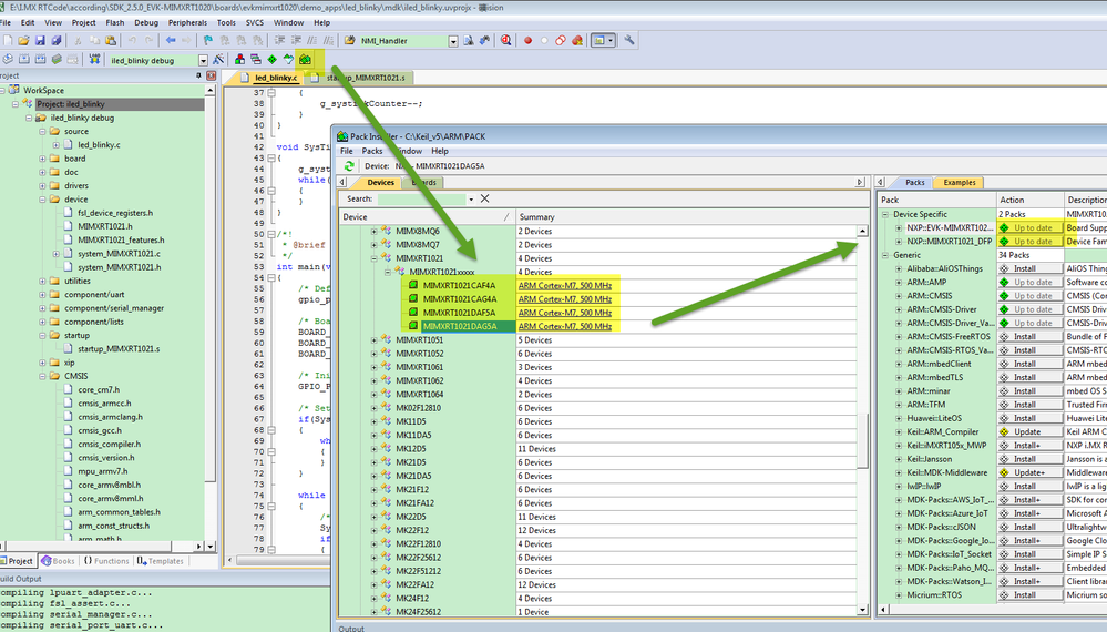

Then please note these points:
    1. MDK version, you need to use the newest MDK version, eg. 5.26.
     2. install the MIMXRT102X CMSIS pack
Then, select the iled_blinky_debug, download the code and run it, whether the LED on board is blinking or not?
After it works, then you can refer to official SDK code to create your own project.
This is my debug result:
Wish it helps you!
