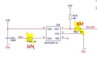

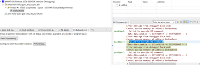

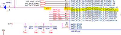

I have meet a wired issue. I use MCUXpresso IDE V11.5.1 on windows 10 PC with Jlink Plus debug tool and NXP MIMX1052CVL5B as a target. I load a SDK example and modify the configuration to use the Jlink's flash driver. and it works and I could load my code to my target successfully. but once I config the M13 pin(GPIO1.25) as GPIO output. I will get an issue as below, I could not load/debug my project. and if I remove the GPIO1.25 configuration, I will load/debug my code sucessfully. so does anyone else meet the issue? need your help.
and console log as below, more info as attched txt.
Note: my HW as below. and my SW package as attached.
Note: at present, I remove the R284 & R281.

jeremyzhou
For QSPI Flash as XIP function, to achieve the highest performance it is recommended to leave the FLEXSPI_A_DQS pin floating and configure the sample clock source as 01-loopback from DQS pad mode to achieve max 133MHz Flexspi_clk. Besides, it is also recommended to pull up QSPI flash
pin1(CE) and pin7(hold) to make sure QSPI Flash boot-up stability

Elsa_7561
Thanks for your reply. and I found the reason. I have configed the clock source as 01-loopback from DQS pad mode, that why I can't config the M13 pin as GPIO feature.
