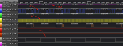

Set the RT685 as a slave, the peripheral control device as the master, and I2S0 can receive data signals from the peripheral device. Then, use I2S1 to send data to the peripheral device, but I2S1 signal cannot be sent out. I2S1 interface uses P0_9 (TX), and the WS and BCLK signals are shared with I2S0 in the circuit design.

Based on your problem description, please check whether both I2S0 and I2S1 are set to slave mode, whether the software initialization is configured correctly, and whether the format of I2S1 is correct.
Please also check the device( the peripheral control device) as the master initialization and I2S interface setting correct.
And also, I suggest you can refer NXP SDK demo ”evkmimxrt685_i2s_dma_record_playback”.
I think this routine is of great reference value to you.
