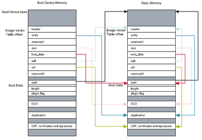

The offset is required to reserve the space for the flashloader and the configurations for the image. In this image, you can find the bootflow for the image
The IVT contains information for a successful boot as the entry address:
To reserve this OCRAM space used in ROM you need modify the start and size of the SRAM on MCUXpresso as step 2 on the User Guide suggests.

Hi Omar,
I think now it's clear. But the mentioned User Guide describes booting from the ITC SRAM, which works fine for me. But as the space is limited there to 256 KiB, I'd like to use the SRAM_OC1.
For this the 0x3000 offset is not enough as a part of the SRAM_OC1 is used in the bootup process as mentioned in this post:
https://community.nxp.com/t5/i-MX-RT/iMXRT1170-boot-from-OCRAM/td-p/1561956
So, is my assumption right that I need to put the program in SRAM_OC1 at location 0x2025000?
In this case I will loose 64 KiB of program space and the maximum size for my program in SRAM_OC1 is 448 KiB. Is this correct?

Omar_Anguiano
This is correct. Since the offset needs to be bigger then the remaining OCRAM space will be smaller.
