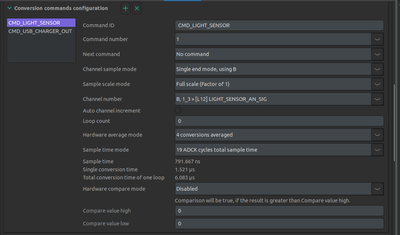

I am using with i.MX1176 and MCUXpresso IDE. 1176 ADC is 12bit. The IRQ function and LPADC settings are as follows:
When i read convValue from IRQ function, it is greater than 12-bit. I read values up to 15-bit. Is it possible?

Hi @SpeedyGonzalesss ,
Thanks for your interest in NXP MIMXRT series!
This is not possible, the maximum measurement range of a 12-bit ADC is 0~4095. If your reading is out of range, there should be a problem with the intermediate processing. Please note if your sampleScale is configured? It is recommended to experiment with known voltage measurement points first.
