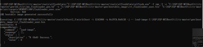

jingpan
Hi @danielberhe ,
1.The image must be compile to 0, not 0x30000000.
2. Then make a flashloader style binary like this.
Jing
