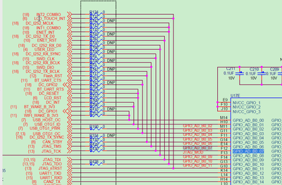

  You can remove R55 if you don't want the C16 influence you when you don't use the M.2 interface:
GPIO_AD_B0_07 is also connect to SWD_CLK, JTAG_TCK, so if you also in the debug mode, you can't see it.
I think you still can use GPIO_AD_B1_02 pin, just remove the capacitor.

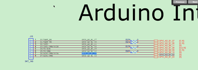

   @MultipleMonomials 's reply is correct, to the EVKB, the used RT1062 chip is the same as the EVK board, so you just need to check the pin GPIO_AD_1_02 in the EVKB, it is the J16_7:
Please also note, this pin also connect to the SPDIF_OUT, BT_RST#, CSI_PWDN, you need to make sure the other module is not using this pin, otherwise, you need to remove the related resistor.

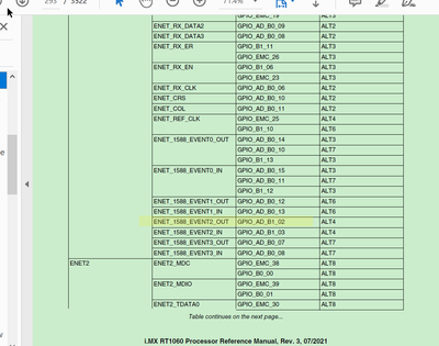

Sorry if this is too specific, but I still cannot see PPS output on pin GPIO_AD_B1_02/J16_7, after making necessary changes in the driver following that application note. I am guessing kENET_PtpTimerChannel3 is the channel to use since interrupts on ENET:1588_EVENT2_OUT are desired. I could not figure out what else was missing - which could be my mistakes.
I saw in the file 'fsl_enet.h' that there is an enum '_enet_ptp_timer_channel_mode' that is not used anywhere. Could you please check if '_enet_ptp_timer_channel_mode' should be used in the code to enable output compare on the desired channel, which is kENET_PtpTimerChannel3?

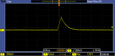

Thanks for your fast reply. I think the problem is with the oscilloscope setting I am using-- it doesn't show the spikes with a very short duration.
In the function ENET_Ptp1588SetChannelOutputPulseWidth, the maximum pulse width is 32 cycles of ptp clock.
* @Param pulseWidth  The pulse width control value, range from 0 ~ 31.
 *                     0  --- pulse width is one 1588 clock cycle.
 *                     31 --- pulse width is thirty two 1588 clock cycles.
1 cycle is 40 ns when the PTP clock frequency is 25 Mhz, so the spike duration is around 1 us - which is almost invisible when the scale is a few seconds. If I zoom in to a few us, I can see a pulse with 1.16V.
So is there a way to increase the pulse width to some ms? And is it possible to change the amplitude to 3.3 V?

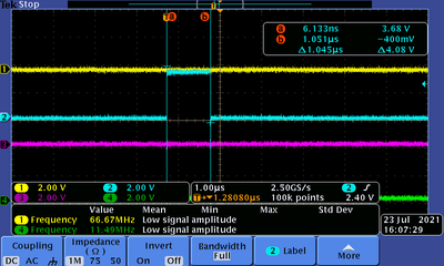

  Thanks for your updated information.
   You can use the oscillator to trigger the pulse, then you can get it, in fact, in the previous time, when I test the RT1170 ptp output, I made the same mistake like you, at last, when I use the trigger, I can get the ns puse like this :
In my memory, if you want to get large pulse, you may need to change the time clock source, but that no meaning to you.
If you just want to get the large pulse, I think, you even can use other timer, instead of the ptp timer, right? ptp timer just have the high frequency. You can adjust your oscillatorscope, just to make sure you can capture the puse at first.

Yes I can observe the pulse on trigger mode. I need pps output from PTP timer specifically, because it is for measuring PTP synchronization accuracy. However, the pulse I see is like this:

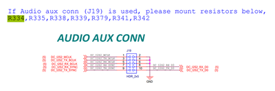

It might be due to large capacitor as @MultipleMonomials mentioned- so I am trying to see if there is other pin I can use. ENET:1588_EVENT3_OUT can be routed to J19_7, so I used channel 4, but I didn't get any output. I checked the schematic and saw this:
Does it mean I need to solder something on the board?
Thanks again!
Wish it helps you!
Kerry
