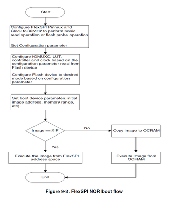

I am trying to boot from external flash using Serial NOR Flash Boot via FlexSPI. I have confirmed that the flash is in working order through debugging, however I am unable to boot from the flash.
I am using NXP MCU BootUtility v2.4.0 to program the flash in serial downloader mode using the evkmimxrt1060_xip_boot_header_dcd.bin DCD provided and my application image file (.s19). Once programmed I can view the bootable image back within the BootUtility so I assume all is well in that respect.

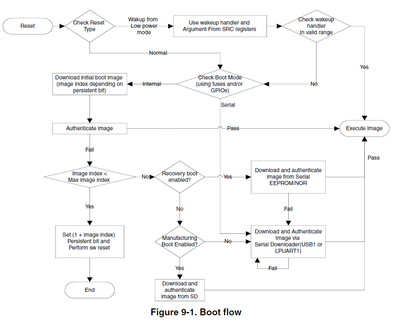

When actually booting however the main application doesn't run. Following Figure 9-1. Boot flow in the reference manual I think it's getting stuck at the "Download initial boot image stage"
Probing the pins on the flash device, I can see activity on the clock, DQ0 and DQ1 pins. The clock frequency is 30MHz so it must be somewhere in the FlexSPI Serial NOR Flash Boot Operation. It seems to be in a loop at this stage however and doesn't progress any further.

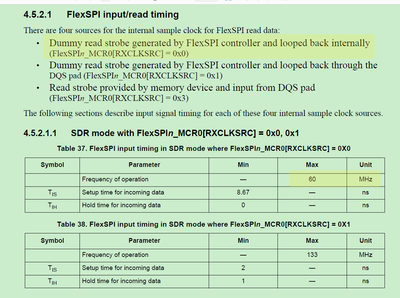

When testing through debugging, I had to change the number of dummy cycles in the read command of the FlexSPI LUT so that the i received the correct data. If this is the same issue, is there any way to edit the LUT at this point in order to read the image correctly into OCRAM?

.readSampleClksrc=kFlexSPIReadSampleClk_LoopbackFromDqsPad,//kFlexSPIReadSampleClk_LoopbackInternally
.csHoldTime = 3u,
.csSetupTime = 3u,
.sflashPadType = kSerialFlash_4Pads,
.serialClkFreq = kFlexSpiSerialClk_100MHz,// This part should smaller than 60Mhz

The DQS pin is not floating, so still using internal loopback.
The updated flexspi_nor_config_t qspiflash_config is:
const flexspi_nor_config_t qspiflash_config = {
   .memConfig =
      .tag = FLEXSPI_CFG_BLK_TAG,
      .version = FLEXSPI_CFG_BLK_VERSION,
      .deviceModeType = 1,
      .readSampleClksrc=kFlexSPIReadSampleClk_LoopbackInternally,
      .csHoldTime = 3u,
      .csSetupTime = 3u,
      .serialClkFreq = kFlexSpiSerialClk_30MHz,

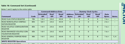

 Can you use the polling_transfer to readout your MT25QL128ABA Nonvolatile configuration register?
 Your quad mode should not be enabled, then the boot quad fast read didn't work.
   You can find from MT25QL128ABA datasheet:
Nonvolatile Configuration Register
This register is read from and written to using the READ NONVOLATILE CONFIGURATION
REGISTER and the WRITE NONVOLATILE CONFIGURATION REGISTER commands,
respectively. A register download is executed during power-on or after reset,
overwriting the internal configuration register settings that determine device behavior.
A WRITE NONVOLATILE CONFIGURATION REGISTER command to a reserved setting
is ignored, flag status register bit 1 is set, and the write enable latch bit is cleared.
You need to enable the quad mode.

Reading the Non-Volatile configuration register returns all default values (0xFFFF).
Changing the LUT of the led_blinky project from 4-PAD to 1-PAD didn't have an effect, it is still not booting.

I've not been able to test the Micron part on the evk yet, but I do have a question about the persistent bits section of the boot process.
"During boot, the core's behavior is defined by the boot mode pin settings, as described in
Boot mode pin settings. When waking up from the low-power boot mode, the core skips
the clock settings. The boot ROM checks that the PERSISTENT_ENTRY0 (see
Persistent bits) is a pointer to a valid address space (OCRAM). If the
PERSISTENT_ENTRY0 is a pointer to a valid range, it starts the execution using the
entry point from the PERSISTENT_ENTRY0 register. If the PERSISTENT_ENTRY0 is
a pointer to an invalid range, the core performs the system reset."
As I said in my original post, "It seems to be in a loop at this stage however and doesn't progress any further", could this be a persistent entry point issue that we're not pointing to the correct location?
I do have a custom board with the ISSI flash part instead but still seem to get the same results as we had with the Micron part.

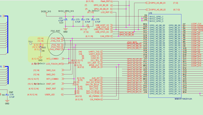

   Now, please help to check, whether you have the SWD interface?
  As your customer board even use the ISSI chip which is the same as the EVK, still has this issues, then it may related to your boot.
  JTAG_MOD has the external 10k pull-down or NOT?
  If you have the SWD interface, please use the JLINK commander, to run it, and halt it, check the SP PC address, whether it is in the ROM or the flash address.
  If you have the JLINK, please try it.
  About the app code, in fact, if you use the SDK led_blinky, that must can work, the boot has no issues.
 But, if you already download some wrong app code, then it will have the boot issues, now can you download the new code with the debugger? Can you debug the code?

Thank you for all the suggestions, we discovered yesterday that it was an issue with the linker script settings. I had been setting to "Link application to RAM" or "Plain load image" when loading into flash, turns out that having neither options ticked was what was needed. So loading iled_blinky project works perfectly fine running from flash.
However, with the actual project there still seems to be an issue. I created a fresh c++ project and added all the drivers that I required and also added some later on as well. Do you know of any particular settings that I might need to check in order to get it running on flash? I'm currently looking at the "Tensorflow" examples as they are c++ based to see if there are any differences between them and my project.
I'm sorry that it took so long to find what turned out to be a very simple issue, and I fully appreciate all the time you've put aside to help me.

It seems that we have solved the issue at last!
Our custom project clock configuration wasn't set up correctly, and we also needed XIP_EXTERNAL_FLASH to be defined also so that FlexSPI clock configuration wasn't changed as well.
Thank you for taking your time to help solve this issue, it is greatly appreciated. Hopefully we won't have any more issues.
