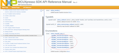

Please check the following link, it describe that eDMA support transfer sizes of  1, 2, 4, 8, 16, 32, 64 bytes, it does not support 24bit(3 bytes) transfer size.
MCUXpresso SDK API Reference Manual: EDMA: Enhanced Direct Memory Access (eDMA) Controller Driver
