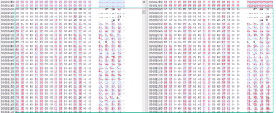

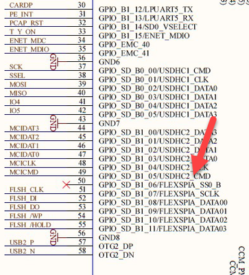

christianroedlach
Hi @jeremyzhou,
thank you for your reply! We read out the images via flashloader tool (blhost.exe) and they differ completely. Please find the attached .zip file containing both readback files. We used following commands to extract the images:

The .zip file also contains a detail of our custom board schematics.

jeremyzhou
Thanks for your reply.
Firstly, after comparing the readback_flash loader.bin and readback_j-link 2.bin, I find the application image is not the same, it's a bit weird and not a normal phenomenon.
Next, for QSPI Flash as an XIP function, to achieve the highest performance it is recommended to left
FLEXSPI_A_DQS(GPIO_SD_B1_05)pin floating and config sample clock source as 01-loopback from DQS pad mode to achieve max 133MHz Flexspi_clk.

christianroedlach
Hi @jeremyzhou,
thank you for your reply. Yes, it looks a bit weird to us as well to see the different images - maybe, they come from additional code generated by the j-link debugger. But we figured out the reason for the toggling CMD pin (GPIO_SD_B1_05 - we already tried to let this pin floating by removing the hw pullups RA300X and RA301X and that did not make any difference, except the idle level of course; the scope pictures I posted earlier actually were taken from the pin floating).
It comes definitely from the differences between 0x0 and 0xFFF (respectively 0x60000000 and 0x60000FFF), which means the code followed by the interrupt vector table at 0x1000. If we overwrite this memory region of readback_flashloader.bin with the content from readback_jlink2.bin and flash the modified readback_flashloader.bin to 0x60000000, everything works fine and GPIO_SD_B1_05 is not toggling any more.
Is there any possibility to influence the content between 0x60000000 and 0x60000FFF when creating the sb file, so that we do not have to edit the .bin file manually?

jeremyzhou
Hi @christianroedlach ,
1) The IDEA can generate the executable file BIN file after compiling the demo project, please compare it with the readback_flash loader.bin and readback_j-link 2.bin, it can help you to figure out the image difference.
2) Whether you mean the replace the section from 0 to 0xfff of the readback_flash loader.bin by the related section in the readback_j-link 2.bin, then program the rewrite bin to the QSPI and MCU can boot up from it, meanwhile the issue just disappeared.
