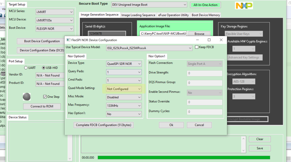

Hi André Rex ,
  Do you try to test the external flash program , erase and readout? All the function works Ok now?
  If the flash operation works OK, then your external flash hardware have no issues.
  Then, could you please enter the serial download mode, and use the MCUbootUtility tool to download the code your external flash?
  You can download this tool from this link:
https://github.com/JayHeng/NXP-MCUBootUtility/archive/v2.3.0.zip
the related user manual is:
You can use the tool's firmware:
NXP-MCUBootUtility-2.3.0\apps\NXP_X-IMXRT1050-VAL_Rev.A1\led_blinky_0x60002000.srec
Can you download it to your flash? This code will toggle GPIO1_IO09.
 About the Nor flash configuration, you can refer to ISSI QSPI flash:
But you need to check your chip QE bit, it is reg1[6]
Please try it on your side.
If you still have questions about it, please kindly let me know.
Wish it helps you!

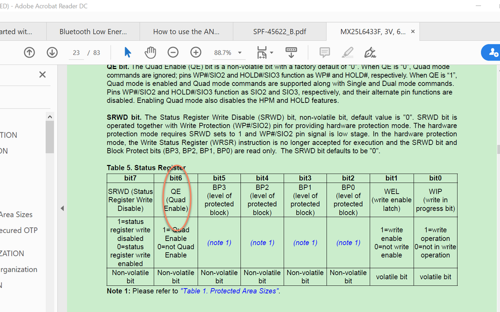

From Macronix' datasheet the QE bit is marked "non-volatile". I'm not sure whether this is to be interpreted as "it is enough to write the bit once; it will survive further power cycles". This would explain why once connected to Flashloader (and configured boot device) the device afterwards boots correctly. That raises the question how to instruct the i.MX ROM loader to set the QE bit prior to read out the flash (via FCB).

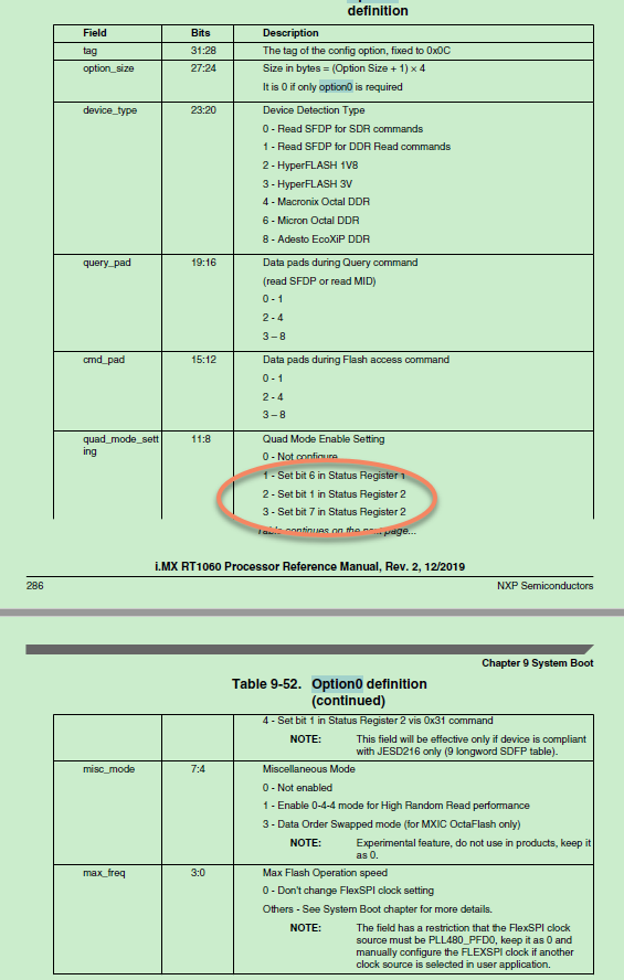

   But from RT1060, the ROM add the option0 and option 1, which can use the ROM code operate it directly.
You can check the RTOM1060RM chapter 9.13 ROM APIs, Table 9-51. serial_nor_config_option_t

  QE bit in the QSPI new flash, just need to write once, after it is wrote, you don't need to write it any more.

# bit [11: 08] Quad Mode Entry Setting
# 0 - Not Configured, apply to devices:
# - With Quad Mode enabled by default or
# - Compliant with JESD216A/B or later revision
# 1 - Set bit 6 in Status Register 1
# 2 - Set bit 1 in Status Register 2
# 3 - Set bit 7 in Status Register 2
# 4 - Set bit 1 in Status Register 2 by 0x31 command

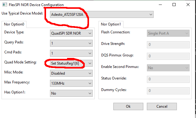

You select the adesto item is the same with my ISSI, in factor, normally the QSPI flash is nearly the same, just need to care about the QE bit position.
 So, if you are in the serial download mode, you still can use your previous command:
./blhost -- fill-memory 0x2000 4 0xc0000105 word

But after quite some investigation the root cause more and more points to the programmer device/software not correctly configuring the QE bit within initial NOR flash programming task (although suggesting to do so). Hence in parallel we opened a request with the programmer's manufacturer.
For i.MX I was finally able to configure FCB accordingly to make the ROM loader enabling QE bit implicitly (writing 0x40 to StatusRegister1 with 'Write Status Register' (WRSR, 0x01) command):
const flexspi_nor_config_t nor_spi_config = {
  .memConfig = {
    .deviceModeCfgEnable = 1u,
    .deviceModeType = kDeviceConfigCmdType_QuadEnable,
    .deviceModeSeq = {
      .seqId = NOR_CMD_LUT_SEQ_IDX_WRITE_STATUS,
      .seqNum = 1u,
    .deviceModeArg = 0x40, // set Bit6 (=QE, quad enable)
    .lookupTable = {
      /* 4 - WriteStatus */
      [NOR_CMD_LUT_SEQ_IDX_WRITE_STATUS*4+0] =
                      FLEXSPI_LUT_SEQ(CMD_SDR       , FLEXSPI_1PAD, 0x01, // WRSR
                                      WRITE_SDR     , FLEXSPI_1PAD, 0x01),
We could use this as workaround as long as the programmer issue isn't fixed - although I'm not happy with it as it writes the status register on each device start.
