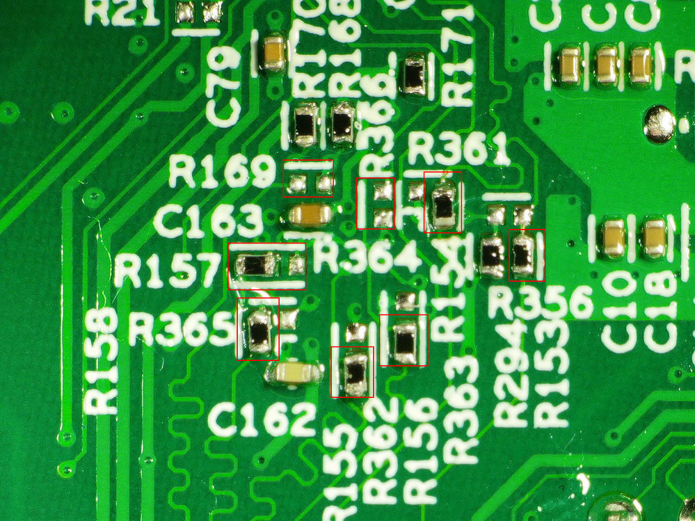

To use the QSPI Flash on the i.MX RT1050 EVK, you must swap zero ohm resistors on the bottom side of the PCB.   The schematic indicates which resistors need changed, however this modification can be difficult because:
1.)   The silkscreen on the PCB is difficult to read.
2.) The RT1050 EVK manual schematic does not mention that the zero ohm resistors for HyperFlash/QPI share a common pads.   Combined with #1,  it makes it difficult to figure out the proper physical configuration.
Here is a photo of the modifications for correct QSPI operation.
Also,  the bootheader will need to be modified to be able to XIP from QSPI.   Using the bootheader from the RT1020 EVK examples will work.    The code below can be used as a replacement for evkbimxrt1050_flexspi_nor_config.c

#endif /* XIP_BOOT_HEADER_ENABLE */

I have done the hardware modification and changed the evkbimxrt1050_flexspi_nor_config.c. But when running code it seems it could not load from the flash. Are there more files to change?

PLease double check the boot mode switces ont he RT1050 EVK
1,707 Views
Sherlock987
yes, thanks for your reply. I have done the switch configuration with the same result. Should it work with simply replacing replacing with this source code? Are there some more configurations required like in MCUXpresso?
