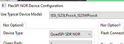

The following sequence works for me (with the same flash on different EVK board):
Then I use NXP-MCUBootUtility with the following configuration:
Of course, download is done in serial downloader mode, after downloading you should switch to boot from QSPI mode.

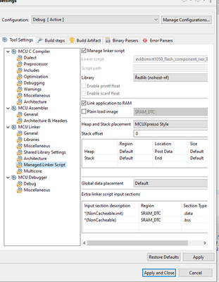

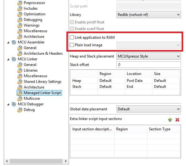

Thanks for the reply. I was able to get the application software to run in internal boot mode after a small change to the project settings. Attached is a screenshot with the correct settings. I had checked the "Plain load image" box when I needed it to be unchecked. XIP is now working properly from the flash device.
