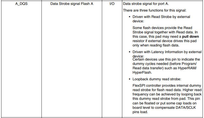

jorge_a_vazquez
Hi Murat Cakmak
Please see below table from the Reference Manual:
If you going to use the SEMC module, in some cases this pad needs a pull-down resistor, this is why this pin is configured with a pull-down resistor.
Hope this helps
Jorge Alcala
2,310件の閲覧回数
muratcakmak
Thank you Jorge, just this pins is not connected to External SDRAM, does it still need a pull down resistor?
