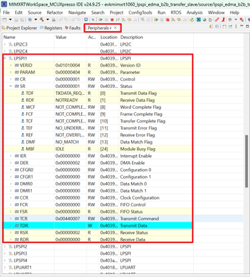

1: So please check Peripherals LPSPI Register status when system crash, whether something abnormal.

1. The register of SPI is normal
