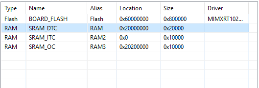

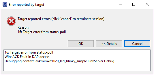

Hi!
When I set DTC memory size to 128k in project settings the chip hangs - I'm not able to attach to it with debugger (LinkServer). What is the reason of such behavior?

Hello Alexander,
     Flash loader needs to occupy more than 64KB OCRAM SIZE due to the complexity of the requirement.
So generally OCRAM size should be 128KB.
Have a nice day!
