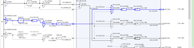

   About the SAI configuration, I highly suggest you use the mcuxpresso IDE, the clock, peripherals tool.
1. clock
 Please note, in the pin configuration, you need to output the MCLK, as your codec need it.You also can check the codec wave.

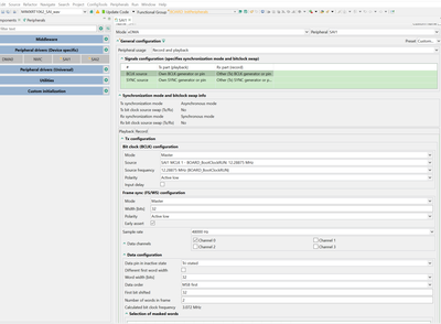

2. About the SAI module, your SAI should be master.
You can configure the output at first, just tx, then check the related SAI_TX_data, mclk, bCLK pin, whether it has the output data.
About the detail EDMA and sai control code, you can refer to the SDK code:
SDK_2.9.2_EVK-MIMXRT1060\boards\evkmimxrt1060\driver_examples\sai\edma_record_playback
Please also note, you need to add the DMA handler code.
