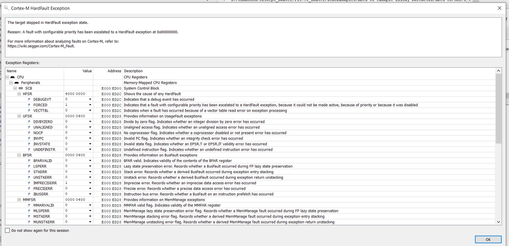

hard fault set, shows Imprecise data bus error after running for several hours.
1,157 Views
niz
When we are doing a durability test on the CAN send and receive, we had the following hard fault after running the software for several hours:
The Imprecise data bus error bit is set in the BFSR register.
The fault happened randomly after the software has been running for several hours.
We are using NXP MXRT1064
Any clue or suggestion would be appreciated.
Thanks a lot for your help.
