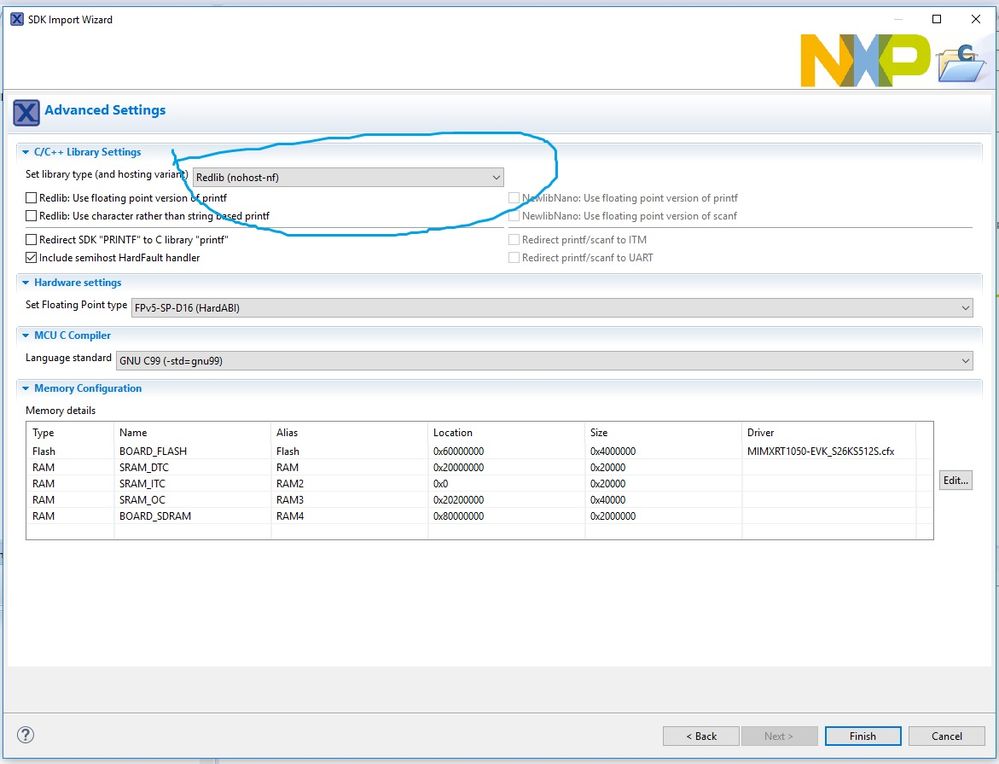

I've installed MCUXpresso and the SDK for the RT1050 eval board.
I've two issues with the setup:
1. TeraTerm is working when the RT1050 boots from flash (build in demo with accelerometer), but is NOT working when I run the evkmimxrt1050_demo_apps_hello_world example. No data is seen in TT, I see however 'hello world!'  in the console of MCUXpresso.
2. The getcher() function is not working, the debugger never returns from it.
So I think I'm not conneted with TT, and something is blocking it in eclipse (don't see a real terminal either as I'm used to have with other suppliers).
Any suggestions?

Hi All,
Thanks for your help here.
The real problem was the powering the board. I had used USB power only.
As soon as I connected a power supply (5V/3A) to the barrel jack all worked fine.

Hi keesvanegmond‌,
When importing the project, there will be an option to called "SDK Debug Console". In there,select UART. And, select the library as "Redlib (nohost-nf)". This configuration should work should enable you to see outputs in Teraterm.
If it doesn't work, please do reply.
