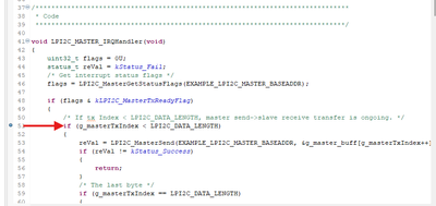

seandutoit
Good day
I rechecked my cables and after powering on the dev board, I still received the same error.
I then proceeded to debug the software and received error 900 at line 294 in lpi2c_interrupt.c
reVal = LPI2C_MasterStart(EXAMPLE_LPI2C_MASTER_BASEADDR, LPI2C_MASTER_SLAVE_ADDR_7BIT, kLPI2C_Read);
if (reVal != kStatus_Success)
return -1;
reVal was 900 here.
After a couple of tried it suddenly started to give me a value of 0 and got
to the breakpoint in the interrupt routine at line 51.
I was expecting the interrupt to be triggered again but it did not.
I then stopped debugging and power cycled the board a couple of times( about 10 - 12)
when it suddenly started working.
I ran the debugger and the code worked.
Now I am just wondering why it suddenly started working.
Is there a list of what an error code means?
