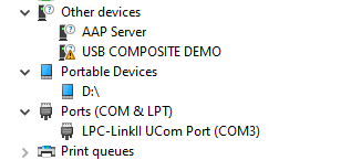

evkbimxrt1050_dev_composite_cdc_msc_bm example COM Port doesn't enumerate

Do the usb composite cdc msc examples work for other people? I can't seem to get the COM port to enumerate. The other cdc examples work fine. I'm trying to work backwards to figure out what is missing but I'm finding the USB code to be very complex.

I had to install the .inf included with the example. I assumed it would auto enumerate like the others but it did not.
