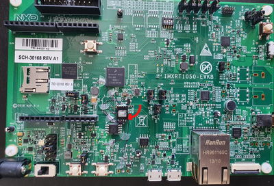

We are new on NXP and testing capabilities to use SPI methods to erase and write data on external flash chip.
our board designers have attached an external flash drive to the evaluation board (1050)as this :
which sdk example should we try in order to verify the capabilities? and what configurations need to be done on the software (IDE) ?

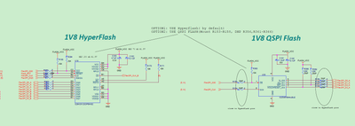

   If it is the QSPI flash, which is needed to test in the MIMXRT1050-EVKB, you need to modify the hardware at first:
OPTION1: USE Hyperflash( DNP R153~R158, Mount R356,R361~R366)
OPTION2: USE QSPI FLASH(Mount R153~R158, DNP R356,R361~R366)
Use option2, remove the on board QSPI flash.

We have connected our own QSPI flash device - not the on board flashes you have talked about - and we want to use some SPI features such as reading its JedecId and erasing the chip etc.

   Yes, I know, from your picture, you are connect your external flash to the MIMXRT1050-EVKB board, right?
   Then, I want to check with you, as the NXP MIMXRT1050-EVKB is using the hyperflash in default. So, when you connect to the related pins, you need to check which package you are using, hyperflash or the QSPI flash, and different flash configuration is not the same.
   And you also need to remove the on board flash, just don't let it to influence your external flash.
  I checked your picture, in fact, I don't think that wire is good connection to make it works. It's better to connect your external flash to the on board package directly, if it is the QSPI flash, you totally can solder it to the U33 package.

my team removed the on board hyperFlash U19 and used the pins to attach our external flash, same one as before.
this configuration suppose to work? or we need to remove the QSPI on U33 and do the resistors rework?
reminder : we are testing single SPI capabilities such as reading JedecID, erasing chip etc.

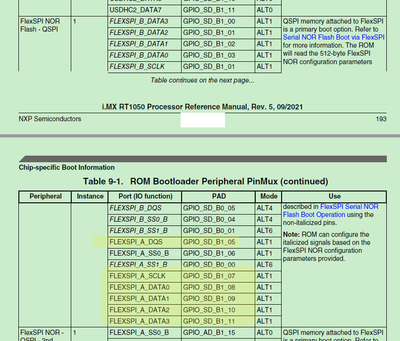

these are the pins we want to configure for programming:

I checked your external flash, in fact, I think, you totally can solder it to the U33 package directly, it should be enough. And the pin should be the same as the U33 package, so I think you can use that package directly, then you don't need to fly wire to chip.
If you use the U33, then you need to use:
SDK_2_11_1_EVKB-IMXRT1050\boards\evkbimxrt1050\driver_examples\flexspi\nor\polling_transfer
SW7:1-OFF,2-OFF,3-ON,4-OFF.

we want all the boot will  be done from flexSPI PORT A and not related to flexSPI PORT B usage.
So to our topic:
all the flashing I am talking about in this discussion should be made from flexSPI PORT B. therefore the pin configuration table i have sent on my previous message.

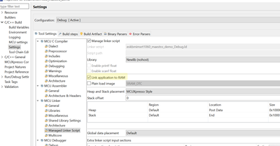

I am trying to run the flexSPI_nor_polling example because our flash is QSPI type
I have made these changes on flexSPI_nor_polling :
and on iomux.h :
but still example is failing (erasing). I believe there is something missing in the code because I can't see the  pins I configured reflect in the code besides in file "pin_mux.h"

2. About the testing code, you are testing modified flexSPI_nor_polling example, and it should run from the internal RAM, right?
