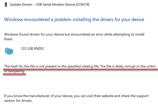

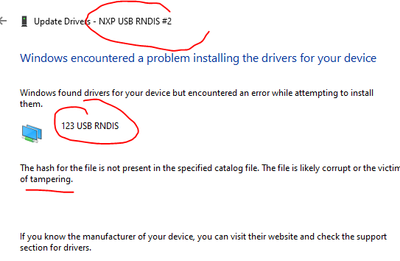

We need to modify device info (strings & VID/PID) in the rndis.inf driver. However windows appears to detect the modified driver as being tampered. Pls let us know how to resolve this issue. Thanks.
; Modify these strings for your device as needed.
[Strings]
COMPANY="123"
RNDISDEV="123 USB RNDIS"
[RndisDevices.NTx86]
%RNDISDEV% = RNDIS.NT.5.1, USB\VID_1FC9&PID_0095
; Decoration for x64 architecture
[RndisDevices.NTamd64]
; Decoration for ia64 architecture
[RndisDevices.NTia64]

Hi @JamesNgo ,
According to the AE's reply, the RNDIS driver needs to be re-signed if the information changes in the .inf file. The signing method can refer to the readme.pdf in the RNDIS demo. About getting a signing certificate, please refer to https://docs.microsoft.com/en-us/windows-hardware/drivers/dashboard/get-a-code-signing-certificate

Test setup on Windows 10, SDK 2.10.0 & RT1020 EVK. Tried it  with virus scan disabled with same error result.

Sorry for the reply late and I basically replicate the issue you mentioned.
Just as the error message reveals, the modified inf can't pass the authentication process when installing the driver, in another word, the Window OS considers that the inf is not trusted.
I guess that the rndis.cat also needs to be updated, but I have no idea how to do it and you may need to ask some driver development engineer for help.

Thanks for your help. However, the driver resigning or usage may be not desirable for our design at this point.
After some research regarding RNDIS USB (configuration-wise) information, I believe the USB configuration could be made to be "Remote NDIS Compatible Device" that is auto-detected by Windows when plugged in; hence the driver could then be not needed.  I'm wondering if there's any info or development work you have available to achieve this as I think that'd be best use case for a generic code sample. Please let me know. Thanks.
