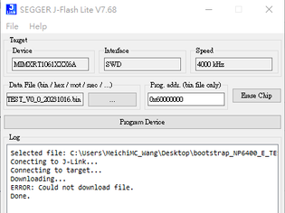

Hi all,
This is the further problem from this question .
I have a problem about porgamming the code by SEGGER J-flash to the customize board which has auto probe.
Firstly, the code was programmed into the flash by flash programmer, and the boot_cfg[0](auto probe) was pull-high.
As expected, the code run correctly after boot.
However, I cannot use SEGGER J-flash to program the flash when boot_cfg[0](auto probe) was pull-high. From the information of SEGGER J-flash utility, the target was connected, but it couldn't download file. Next step, we made boot_cfg[0](auto probe) pull-down. And then we can program the code successfully and the code run.
The other experiment was programming the code by daplink to the customize board which had auto probe. It was also successful to program the code to the flash.
Therefore, I am curious the reason why I cannot use SEGGER J-flash to program my code when boot_cfg[0](auto probe) is high?

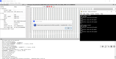

Hi @MCW ,
  I have finished the MIMXR1060-EVK with MXIC 25L12833F, the JFlash downloading also works.
  I attach my image and picture, I just use the JLINK driver default flashloader.
 My test segger driveris V7,88d.
You also can test it on your side, and compare with your customer board.
Kerry

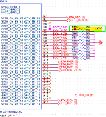

MCW
Hi @kerryzhou ,
1. Do you connect the auto probe to the JLINK JTAG interface or not?
Ans: No. Directly to 3.3V.  Only BOOT_CFG4, BOOT_CFG7, BOOT_CFG6, BOOT_CFG10 and BOOT_CFG11 will be set to GPIO pin use after boot.

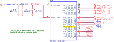

kerryzhou
Hi @MCW ,
  Please help to check, whether your FlexSPI DQS pin is float or not? If your DQS is used in the custom board, then your FlexSPI frequency will limit to 60Mhz, this is also important.

MCW
Hi @kerryzhou ,
Thanks for your advice.
I checked the schematic of my custom board again.
The DQS pin is floating.

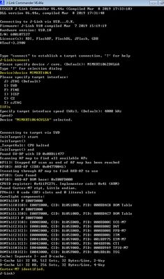

kerryzhou
Hi @MCW ,
   Thanks for your information.
  To the JTAG pin, pin 1 3.3V is must, otherwise, your JTAG/SWD can't work, you can check this log:
The VTref is used for the JTAG to detect the voltage.
Wish it helps you!
Kerry
