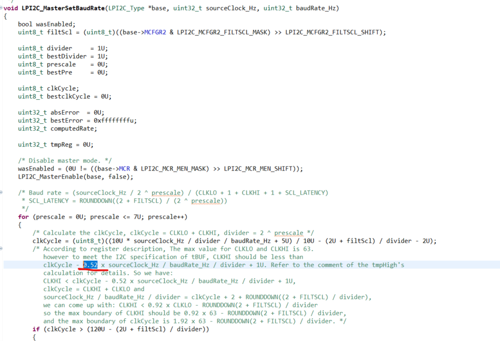

recently, i study the lpi2c driver of i.mxrt1170.
and i can't find the factor 0.52 in the driver software come from.
is anyone aware of it?

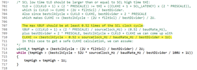

Hi @fuyunezu,
This 0.52 value comes from the tmpHigh function definition on line 713 of the "fsl_lpi2c.c" file:
I hope this helps.

fuyunezu
Hi EdwinHz,
Thanks to your reply.
I have noticed it, but it still can't explian this factor. I have looked up the "UM10204" which published by NXP, and I can't find any statement to explain the relationship between tbuf and scl clock cycle except the table which tell us the recommand value.
