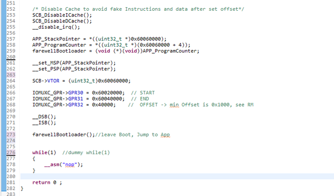

Second temptative - jump with offset
Starting from a mass erase, I loaded the same App used previously (compiled at address 0x6002_0000) at address 0x6006_0000, I defined the offset and relative regions (setting IOMUX_GPRx). This is the code:

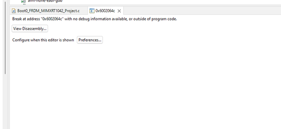

In this case the jump to App doesn't run as expected , I mean when the debugger enters the farewellBootloader() it gives me the following error and the blinking led example doesn't start.
What is wrong in my jump with offset?

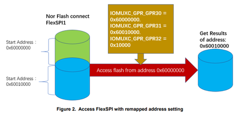

Hi @riccardo_carlot
Can you try with the same offset as in the following example:
Look how we do it in the example:
GPR30 start address
GPR31 end address of first partition
GPR32 offset (start of second image)
the second firmware should remap to @60010000 according to the offset setting
Nada
GPR30 start address
Nada
