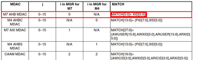

As the RM describes, in our case we have the following match options:
M7 AHB MDAC 0~15 0 N/A MATCH[5:0]= XID[5:0]
M7 AXI MDAC 0~15 1 N/A MATCH[27:0]=
{AWUSER[15:8],AWXID[5:0],ARUSER[15:8],ARXID[
5:0]}
a) In the case of bits AWUSER,ARUSER, we don´t know how to modify them inside the M7 v7 core by software, if there is a way, please tell us.
b) In the case of XID / AWXID / ARXID

To my understanding, when configuring the Master Domain Access Control (MDAC), we can assign multiple domains to each bus master. Each assignment will have its match and mask. When a transaction from the bus arrives at the MDAC, it is responsible for reviewing the transaction, checking its assignment table, and if there is a match, assigning the domain to the transaction. If this is the case, who is responsible for assigning that information which the MDAC will then verify for a match? What is that information?
From what I have seen, this information is detailed in Table 43-2 of the Reference Manual. However, the bits used for the match are not editable in most cases. I only see that we can differentiate domains based on the match in the case of the EDMA, where the match bits form the channel and the master ID. Given this, among all the bus masters, does it only make sense to assign multiple domains to the EDMA masters?
Additionally, what is the purpose of being able to add multiple domains, for example, to the Master M7 AHB MDAC if we cannot change the MATCH bits of the transaction?

Q2: Is it possible to have 4 domains inside the M7 core , customer mean M7 AHB and M7 AXI masters (the example is just one domain)? their use case is to have 4 task inside the M7 core, and they would like to have isolation (peripherals and memory) between tasks, isolation means that one task can not write the memory of the other task and can not access the other tasks peripheral. How could have they do it?
A: For 4 tasks inside the M7 core, please use M7 thread/handle and MPU to do the core isolation, xRDC2 is for others isolation (SOC's other masters and peripherals and memory) in M7 core domain. this same as one core case.
Q3: How can I dynamically change the execution domain for each task? how can I ensure that the critical task executes with the permissions of domain 0 and the non-critical task with the permissions of domain 1? How to implement the assignDomain
A: Domain can't be changed dynamically. You could use shared peripheral and memory in two cores case. In one core case, task isolation could be changed and configured dynamically.
Q4: When configuring the Master Domain Access Control (MDAC), we can assign multiple domains to each bus master. Each assignment will have its match and mask. When a transaction from the bus arrives at the MDAC, it is responsible for reviewing the transaction, checking its assignment table, and if there is a match, assigning the domain to the transaction. If this is the case, who is responsible for assigning that information which the MDAC will then verify for a match? What is that information?
A: The XRDC2 memory protection scheme has two components. 1. First each bus mastering resource has an associated Master Domain Assignment Controller (MDAC) for assigning a domain identifier (DID) attribute to each bus transaction. 2. Second each memory and peripheral has an associated access control submodule that enforces access control policies based on the DID and privilege level of the transaction.
The MDAC submodule is responsible for the generation of the DID, nonsecure and privileged attributes for every system bus transaction in the device. The MDAC compares its match input to the MATCH field for each enabled MDA descriptor for each bus transaction.
Q5: From what I have seen, this information is detailed in Table 43-2 of the Reference Manual. However, the bits used for the match are not editable in most cases. I only see that we can differentiate domains based on the match in the case of the EDMA, where the match bits form the channel and the master ID. Given this, among all the bus masters, does it only make sense to assign multiple domains to the EDMA masters?
A: I supposed that you did some mis-understanding on "domain", please also read the RDC chapter, then it will help you to understand MDAC.
Q6: Additionally, what is the purpose of being able to add multiple domains, for example, to the Master M7 AHB MDAC if we cannot change the MATCH bits of the transaction?
A: Please search and refer  "MATCH field" description in register map - Master Domain Assignment (MDAC0_MDA0_W0 - MDAC31_MDA31_W0).
