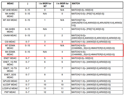

For Table 43-22. i.MX RT1170 XRDC2 MDAC Details ID information:
• XID: AHB bus version of the Extended ID format
• AWXID/ARXID: AXI bus version of the Extended ID format
• AWUSER/ ARUSER: AXI bus user bits
• AWICID/ARICID: AXI Write/Read Isolation Context Identifiers(ICID) from
CAAM
• PID: Process id from M4 MCM. See the Arm Cortex M4 Platform chapter for more
information
• CHANNEL_ID: channel id from EDMA, indicates DMA channel index
• HMASTER: Master id from EDMA, indicates the master id of master that
programmed the DMA channel that is active
For Extended ID format, please refer to Table 43-3.
Case of customer is “the two tasks will be executed on one core”, in this case which values of the XRDC2 MDAC registers should customer use (XID, AWUSER, … ) or it must be done using the MCU and the XDC2 MDAC is not valid for isolation of two task resources inside the same core (this means the XRDC2 objective is just for multimaster exclusion (ENET, DMA, AHB, AXI, ..) without any relation with the software tasks ?

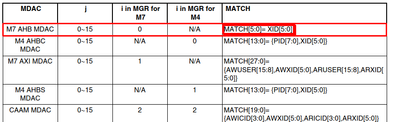

Thank you for your explanation, I am going to try to focus the situation with comments to parts of your answer, and I have written the main question / doubt at the end.
- "I supposed that tasks should use the core AHB, AXI 's MDAC" => That is our case.
- "XID,AWXID/ARXID,AWUSER/ ARUSER,  please refer to M7's AHB/AXI reference manual or M4's AHB reference manual provided by ARM and Table 43-3. Extended ID provided by 1170RM."
"Extended ID provided by 1170RM" => We have been reading the manuals that you describe and Table 43-3.
As the RM describes, in our case we have the following match options:
M7 AHB MDAC 0~15 0 N/A MATCH[5:0]= XID[5:0]
M7 AXI MDAC 0~15 1 N/A MATCH[27:0]=
{AWUSER[15:8],AWXID[5:0],ARUSER[15:8],ARXID[
5:0]}
a) In the case of bits AWUSER,ARUSER, we don´t know how to modify them inside the M7 v7 core by software, if there is a way, please tell us.
b) In the case of XID / AWXID / ARXID

To my understanding, when configuring the Master Domain Access Control (MDAC), we can assign multiple domains to each bus master. Each assignment will have its match and mask. When a transaction from the bus arrives at the MDAC, it is responsible for reviewing the transaction, checking its assignment table, and if there is a match, assigning the domain to the transaction. If this is the case, who is responsible for assigning that information which the MDAC will then verify for a match? What is that information?
From what I have seen, this information is detailed in Table 43-2 of the Reference Manual. However, the bits used for the match are not editable in most cases. I only see that we can differentiate domains based on the match in the case of the EDMA, where the match bits form the channel and the master ID. Given this, among all the bus masters, does it only make sense to assign multiple domains to the EDMA masters?
Additionally, what is the purpose of being able to add multiple domains, for example, to the Master M7 AHB MDAC if we cannot change the MATCH bits of the transaction?
CAAM
information

A: The XRDC2 memory protection scheme has two components. 1. First each bus mastering resource has an associated Master Domain Assignment Controller (MDAC) for assigning a domain identifier (DID) attribute to each bus transaction. 2. Second each memory and peripheral has an associated access control submodule that enforces access control policies based on the DID and privilege level of the transaction.
The MDAC submodule is responsible for the generation of the DID, nonsecure and privileged attributes for every system bus transaction in the device. The MDAC compares its match input to the MATCH field for each enabled MDA descriptor for each bus transaction.
Q5: From what I have seen, this information is detailed in Table 43-2 of the Reference Manual. However, the bits used for the match are not editable in most cases. I only see that we can differentiate domains based on the match in the case of the EDMA, where the match bits form the channel and the master ID. Given this, among all the bus masters, does it only make sense to assign multiple domains to the EDMA masters?
A: I supposed that you did some mis-understanding on "domain", please also read the RDC chapter, then it will help you to understand MDAC.
Q6: Additionally, what is the purpose of being able to add multiple domains, for example, to the Master M7 AHB MDAC if we cannot change the MATCH bits of the transaction?
A: Please search and refer  "MATCH field" description in register map - Master Domain Assignment (MDAC0_MDA0_W0 - MDAC31_MDA31_W0).
