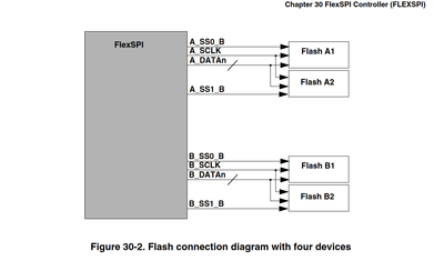

Our Setup:
i.MXRT1176
IS25LP01G Flash Devices with 1Gbit / 128Mb
We use it in individual Mode. I expected that i can access Flash A2 via address 0x38000000. A1 Range will be 0x30000000 to 0x37FFFFFF.
We connected four NOR Flash Devices on FlexSPI Port A1/A2/B1/B2. I am only able to access A1 via XIP. Try to Read via memcpy at the Address 0x38100000, which should be Chip on A2, i get values of 0x30100000 from Chip on A1. It seems XIP does not support multiple Chips? I am right?
I took a example from flexspi_nor_flash_polling and added Port selection. I can Program values to the A2 Chip. B1/B2 not tested yet.
Is it otherwise possible?
Thank you,
Florian

1) It seems Xp does not support multiple Chips?
-- No, you can access the other chips other than the A1 via the AHB bus.

Hi jeremyzhou,
I could understand that access A1 flash using XIP mode, and access A2 flash using AHB interface. After access A2 flash (need initialize flexSPI interface), Does need i reconfigure flexSPI to access A1 flash using XIP mode
