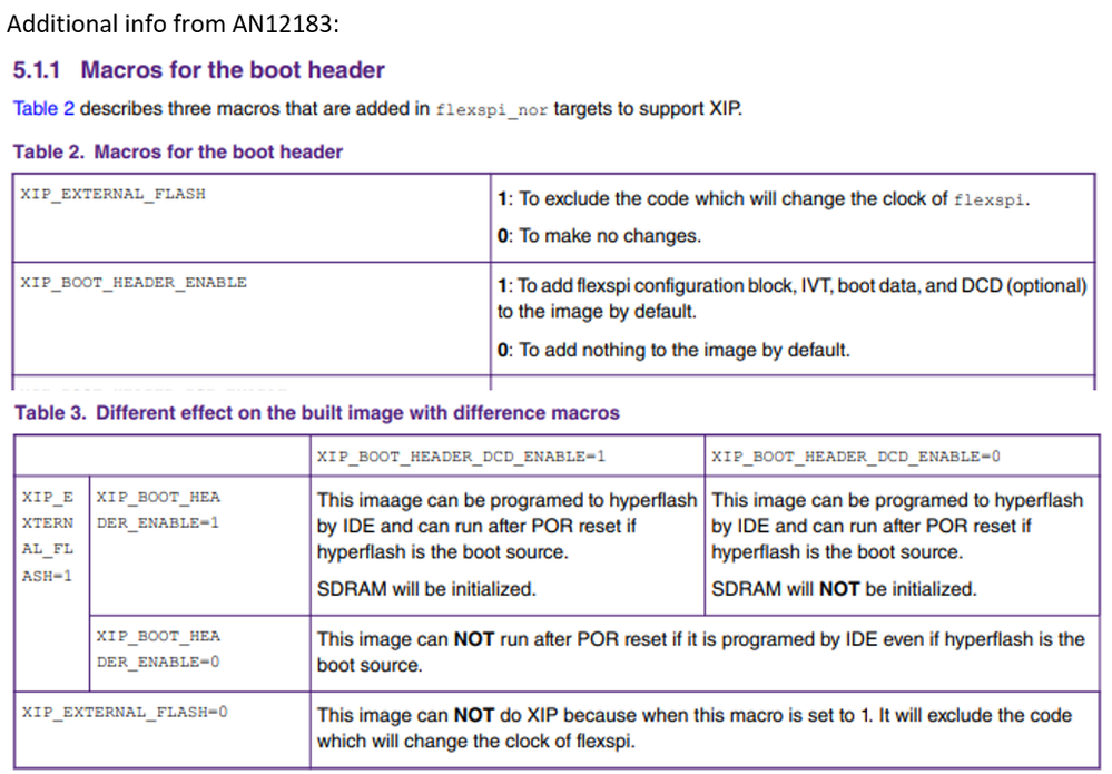

For someone who is looking for a detailed explanation, this is what my team found out from our own research:

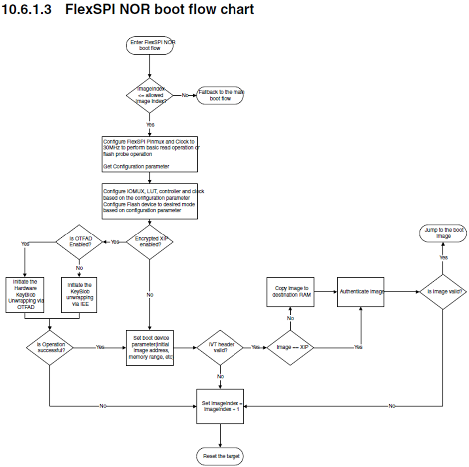

The XIP_BOOT_HEADER_ENABLE pre-processor symbol controls whether the flexspi config block, IVT, boot data and DCD (optional) is added to the build's image or not. If it is 1, this information is added, if it is 0, the information is omitted. It must be 0 to load the project to the processor via ISP (with MCUXpresso Secure Provisioning Tool), because this information is added to the image during this process. This symbol must be 1 to load the project to the processor via debugging probe, otherwise this information is not written to the internal flash.
According to the RT1170RM (see below), the target will be reset if the IVT validity check fails. The trap is that the IVT validity check will pass if you at first load your project with this symbol = 1, and then later change it to 0 in the project settings. The IVT will be correctly saved in flash, and it will not be overwritten until you debug a project with this symbol equal to 1. Because the initial testing worked with this symbol equal to zero, we assumed that everything was fine. Later on, we debugged another project. Then when we debugged our project again, it only worked during the same power-cycle session as a debug. After a power-cycle, the board would stay in reset. This was because the IVT information persisted from the ‘other’ project we debugged. This caused the IVT validity check to fail, resulting in a reset.
