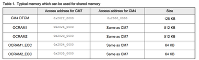

The RT1176 is a dual-core processor. By default, CM7 is the primary core and CM4 is the slave core. If you need to change the primary core to CM4, you need to flash eFuse.

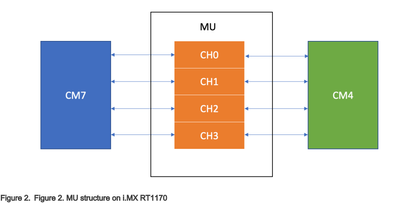

In dual-core applications, there are three main methods to keep the two cores in sync.
1.MU(Message Unit)
2.SEMA(Semaphore)
3.Shared memory

Would you like to know how the applications on the two cores can communicate?
The 1170 has a messaging unit that can be used to exchange values and generate interrupts on the other core.
However, a shared memory area is better suited for exchanging larger amounts of data.
