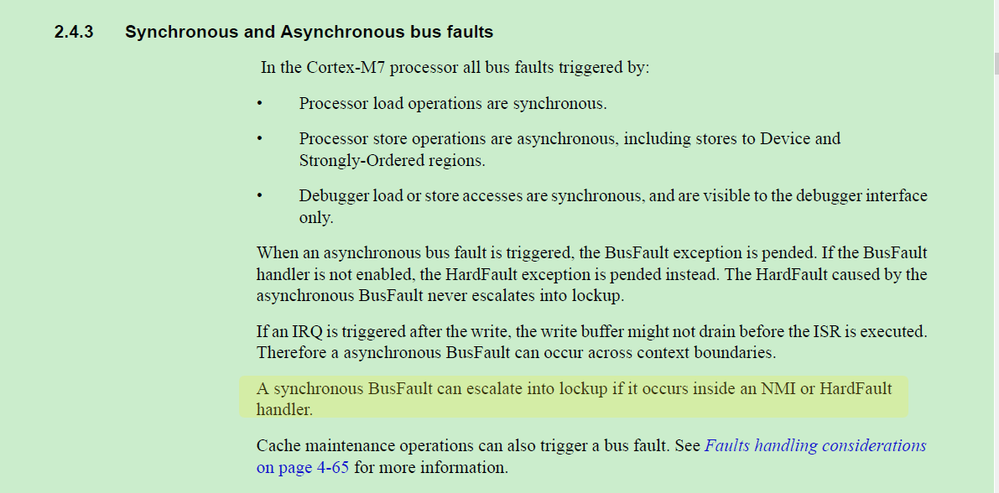

  About the lockup, as I know, the ARM core if get busfault and didn't clear it, the new fault is coming, then it will meet the luck up issues.
  Please check the cache application note again.

You say busfault - if a busfault occurs, it should go into the busfault handler right? It does not go into a busfault handler.
Surely all faults should go to the respective handler? Then the debugger can halt the processor and we can detect the fault.
Chris.

   So now, even you do all the related items in the AN12042, you still meet the lockup issues?
   In the previous time, I also meet other customer meets the lockup issues, it at last is caused by the ARM speculative prefetch issues.
   About why it is lockup issue, not the busfault issue.
  You may find some information from the ARM core document.
   This issue should also related to the ARM core, please check more details in the ARM cortex M7 document:
Documentation – Arm Developer
Kerry
