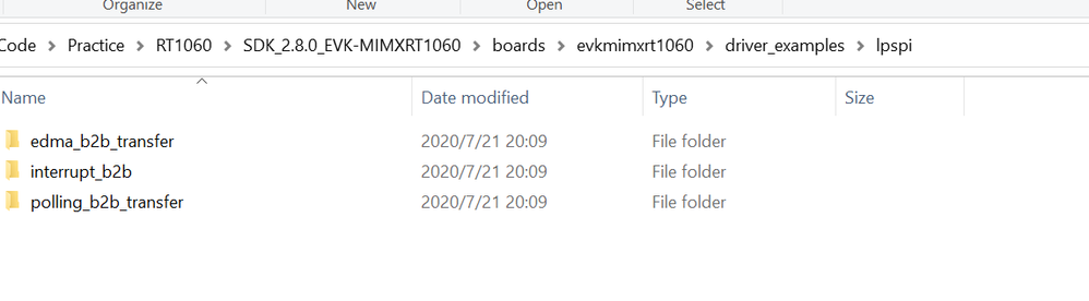

kerryzhou
Hi  Alex Duh ,
   Which RT1060 code you are running now, the SDK?
  I didn't find lpspi_loopback example in the newest SDK.
So, I suggest you download the newest SDK, and test the SDK lpspi code, it works OK.
The SDK can be downloaded from this link:
Welcome | MCUXpresso SDK Builder
Wish it helps you!
If you still have questions about it, please kindly let me know.
Kerry
